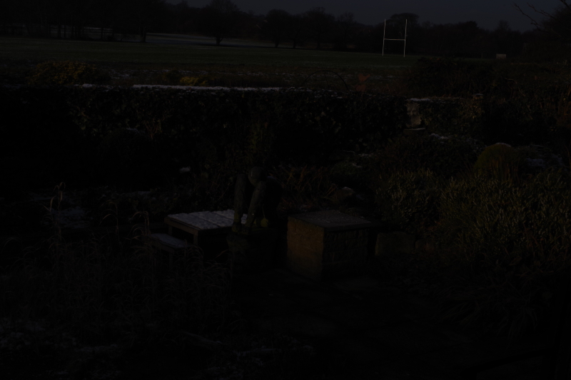

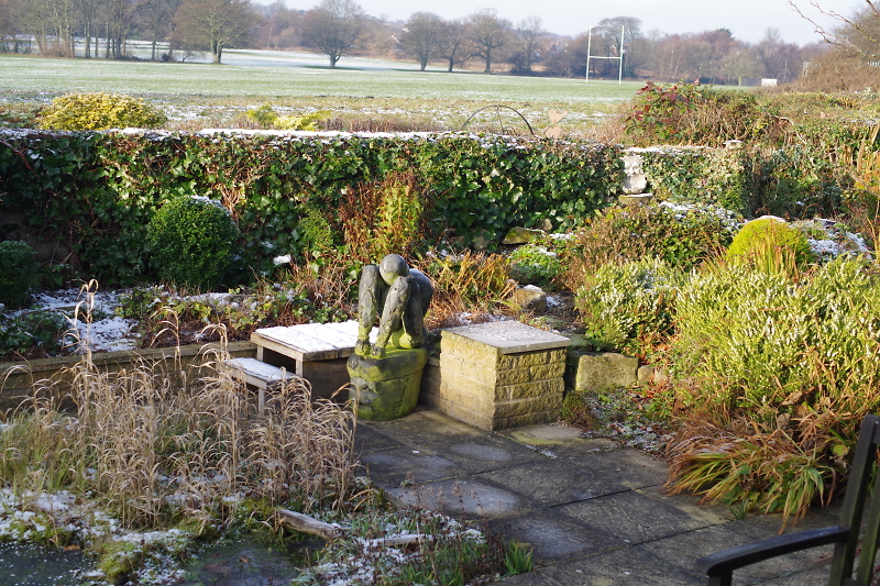

The number of dark images varies, the most being six.
Here is the same subject showing adjacent shots
Can anyone suggest the reason for this occurring?
