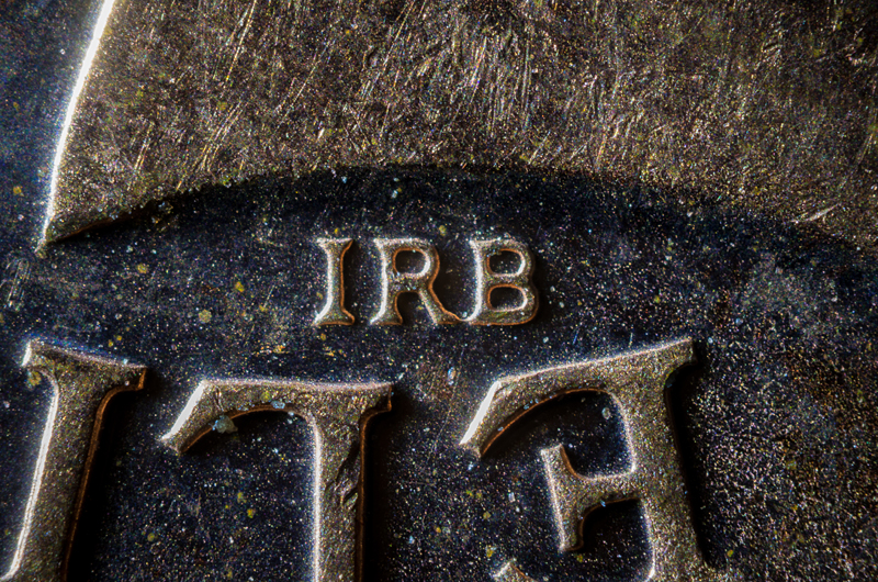

It's time a few of us wasted a bit more time on this
Whenever I want to muck about or try a bit of Heath-Robinson Macro, I always use the 'penny test'.
English penny - look under the Queen's head for a little dot (they don't all have them).
Photograph it as well as you can using anything you like.
Display THE WHOLE IMAGE no crops.
Points awarded for ingenuity, clarity, size, general photographic merit and size. Did I mention size?
Points deducted for using macro lenses
An extra photo of your set-up would be nice.
Here's my starter for 10...
Extension tubes, helicoid from fuji lens, El-Nikkor 50 2.8 enlarger lens, Raynox element taped to the end. Sunlight.

The IRB on the penny is slightly under 1.5 mm I think. So my image is about 3.5 x macro. So you have the advantage there by the looks of it.

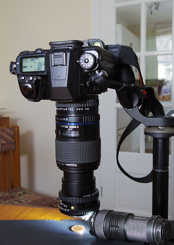

I don't have any extension tubes so this is my best attempt with what I could lay my hands on:
Shot straight on because the DOF is exceedingly shallow.
I will loose points because in the middle of my set-up was a 100mm macro lens:
K-5 with 2x teleconveter followed by the Samsung equivalent of the DFA100 macro back-to-back with a Pentax-A 50mm 1:1.7. It had to be fairly close to achieve focus, shadowing the subject, so the light was provided with a little LED torch.
What looked like a fairly new and shiny 1P coin appeared rather nasty at this magnification .
