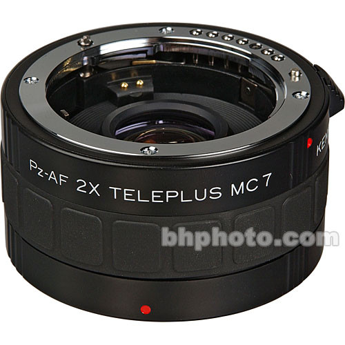

DA 300 + TC
cedricd
Posted 22/06/2009 - 19:18 Link
Has anyone used a TC with this lens. Stefan passed a comment in the post asking which 5 lenses would you have. I tried the lens with my Kenko 2 x TC (it has the contacts) but could only be used with manual focus. Would be nice to be able to use AF. Used on K10D.
Cedric
Enjoy life
aminstar
Posted 22/06/2009 - 20:04 Link
Hi Cedric
yes you can use the Pentax 1.7x Adapter. Put the lens into MF and give it a nudge to bring to close to focus and then let the adapter do the job.
But you get normal AF with it.
If you want SDM then you will need the Tamron 1.4TC.
Just make sure that its the one with 1.4X Pz-AF MC4 written on the TC. This one works with SDM and gives you full SDM function with the lens. I believe that there is another version of this tammy that will not work with SDM.
Lastly, if you want the highest quality then nothing beats the pentax Adapter the first one I mentioned.
Hope that helps.
cedricd
Posted 22/06/2009 - 21:10 Link
Hi Amin, the 2 x Kenko has the contacts for SDM plus the drive for camera drive AF. I had rather hoped not to buy another TC. It`s a Kenko DG Pz-AF 2X TELEPLUS MC7. Which is I believe tamron in any other name. So Failing this I guess I need to look for the Pentax TC.
Cedric
Enjoy life
Anvh
Posted 22/06/2009 - 21:27 Link
DG Pz-AF 2X TELEPLUS MC7 should work I believe don't have it though.
It does make good contact with the lens and camera right?
Stefan
K10D, K5
AF-540FGZ
cedricd
Posted 22/06/2009 - 21:34 Link
Stefan, I have wiped the contacts. It works with my Tamron 28-300. Seems a little odd that with the DA 300 nothing happens.
Cedric
Enjoy life
aminstar
Posted 22/06/2009 - 21:36 Link
cedricd wrote:
Hi Amin, the 2 x Kenko has the contacts for SDM plus the drive for camera drive AF. I had rather hoped not to buy another TC. It`s a Kenko DG Pz-AF 2X TELEPLUS MC7. Which is I believe tamron in any other name. So Failing this I guess I need to look for the Pentax TC.
Cedric
Cedric,
There were a few threads around here that a lot was discussed about TCs and the compatibility of them for specific lenses.
A few of our veteran members such as Stefan and others here are very well versed in this matter, its just a question of you getting hold of attention of one of them who knows about this specific TC.
One of the members from this group of well versed people in TCs is Mike-P because he has had a few over the years and has a lot of first hand experience. Get hold of him and he will clarify to you in an instant.
cedricd
Posted 22/06/2009 - 21:46 Link
Thanks Amin, will try and search Mike P out.
Cedric
Enjoy life
aminstar
Posted 22/06/2009 - 21:53 Link
cedricd wrote:
Thanks Amin, will try and search Mike P out.
Cedric
Catch him now, he is around as I see him replying to some comments just a few seconds ago
Anvh
Posted 22/06/2009 - 21:55 Link
The Kenko DG Pz-AF 1.5x TELEPLUS MC works for sure, there are many reports on that on the web and thought that the 2x should also work, it's basically the same so strange...
Will look more on the web for you don't know if i find anything though
This the one right, just to make sure.
Stefan
K10D, K5
AF-540FGZ
Edited by Anvh: 22/06/2009 - 22:04
Anvh
Posted 22/06/2009 - 22:12 Link
hmm this might be it link
You got MC and not an SHQ version, that might be it.
Like Amin said I ain't no expert and don't have the TC but believe no one has it here
Stefan
K10D, K5
AF-540FGZ
Clarky
Posted 22/06/2009 - 23:02 Link
Yes you need the SHQ version for it to work with your DA*300. I had the non SHQ version and couldn't figure out why it wouldn't work until someone here raised it.
I ended up getting the Pentax 1.7 adapter and the Tamron 1.4 and both work with SDM.
Camera:|K-7|
Unlocker
Posted 23/06/2009 - 09:49 Link
300mm F4 + 2x converter = 600mm F8.
Didn't think autofocus worked at F8, not enough light?
Anvh
Posted 23/06/2009 - 12:24 Link
Unlocker wrote:
300mm F4 + 2x converter = 600mm F8.
Didn't think autofocus worked at F8, not enough light?
Depends also on how much light there is but even without enough light it should hunt, it doesn't even do that.
Stefan
K10D, K5
AF-540FGZ
cedricd
Posted 23/06/2009 - 20:00 Link
Hi Stefan, thank you very much for your help. Yes it is the one in your picture. I tried it today in seriously bright sunlight and absolutely nothing happened.
Cedric
Enjoy life
beginner
Posted 23/06/2009 - 21:26 Link
The Pentax 1.7 adapter is my preference!.....gives you 510mm 6.7...and there is no noticable difference in image quality.....and you can still find them out there.....Ken
K20D...ist DS ,DA18/55,DA16/45.DA* 50/135,"A"1.7 50MM..."A" 70/210..M 50mm f2...Tamron 90mm macro,28/300 Tamron,200/500 Tamron 6.9....A Pentax DA*300... Sigma10/20,FA31mm 1.8 Ltd*********,FA 77mm Ltd!
