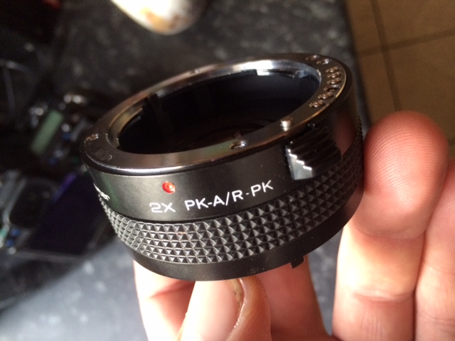

Problem with this item teleconverter

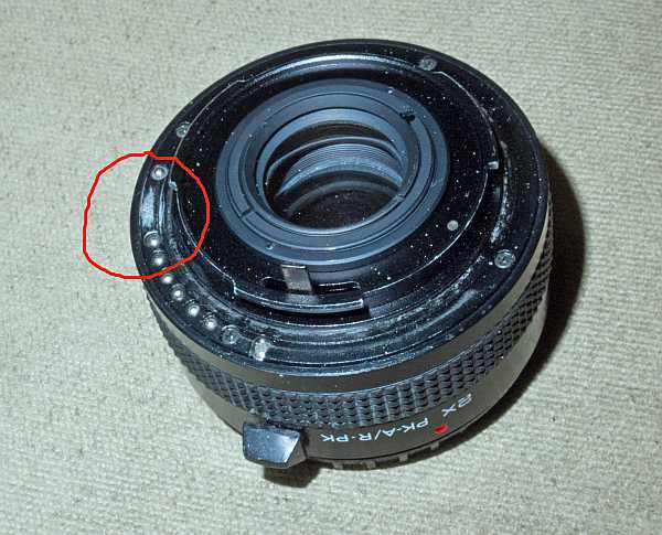

It's probably not getting an earth return. If you scrape of some of the black anodising as in the picture below it should make it work.
John K

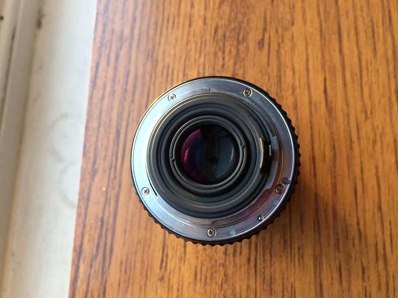

Posted 11/12/2013 - 15:33
Check how that contact at about 120 degrees round from the top lines up and see if it corresponds to the section on my converter that I scraped off.
John K
Posted 11/12/2013 - 15:34
@daydream jay
the photo before yours is of the teleconverter rather than the actual lens
Posted 11/12/2013 - 16:06
Yes, the bottom of the converter, not the lens! (My converter would appear to be the same make/model as yours.)
John K
Posted 11/12/2013 - 18:10
That's the same single contact that I have on my 50mm f1.7 so no reason why it shouldn't work. I've just tested the combo on my 5iis and it's fine. Looks like a good clean of the contacts is in order.

I have cleaned the contacts and still nothing.
The F on the LCD display on my camera just has - - next to it.
I tried it with my 50mm FA 1.4 lens too with the same result.

It seems to be a similar porblem to several 'PKA' extension tubes where the earth return is not being made.
Looking at the e-bay link it looks like the bottom of the TC is anodised so scratching the base of the TC as per JAK's photo should do the trick.
If this doesn't work it might be that there isn't a return conection between the ends of the TC or that one of the other contacts/wire has broken. Try checking each in turn with a multimeter. There should be very little resistance (no more than a few ohms) between coresponding contacts on front & back faces. My money's on the scratching.
The lens itself doesn't have the cresent of contacts but does have the only one used for a 50mm. Many lenses only have a few of the contacts, which ones varies based on the focal length.

Not sure how to say this differently. Yes you are correct, the lens isn't getting an electrical connection through the teleconverter. You have already stated that the lens works fine so cleaning those contacts won't help. But one of those contacts, the earth return is being blocked by the black paint on the converter. The ONLY solution is to do as suggested above, and yes, scraping that anodising off the converter allowed mine to connect and resolve the same problem you are experiencing.I have cleaned the contacts and still nothing.
If you try an internet search you will find others who have provided this solution in the past and why I made this drastic (not really) modification to mine.
Why did you ignore the suggested solution given yesterday?
John K
