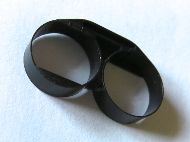

Just had a look at mine and I think you'll find the batteries will fit in just fine without the little holder as all the connection/conductors are in the camera body not the holder, they're just a bit more tricky to get back out.
Holder looks like this:
Batteries inserted without holder - Note that the top one goes in with the +ve to the right, and the lower one is reversed.

Thank you for your help crossed-up I will try that when I get my batteries,
What stops the batteries from touching each other or does that not matter.
Christopher.
It probably would. Cut a small bit of plastic off something and slip it in between them. K.
Christopher.

Thanks for your help eveyone I put the batteries in as suggested by crossed up
and I have power yeah now of to Lomography to order some 110 film

Yes, it would matter if they touch, but the compartment is actually shaped to keep the cells separated. The recess follows the shape of the bottom holder, so each cell actually sits in a little semicircular trough.
EDIT - oops, I posted before I saw that you had replied above! Glad you have it working.
