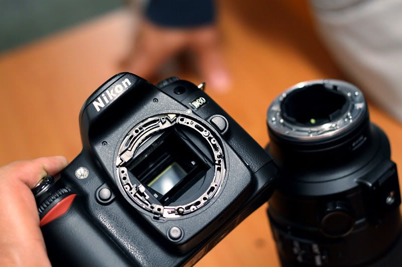

Most lens mounts are only held on with 3 or 4 small screws anyway. There was an uproar in the 70's when Canon replaced their breech mount held with 4 screws with a lighter one using just 3
I use a Tokina 400mm lens that hasn't got a mount on it without any problems.
I don't think the force is all that high. If you can pick the lens up by the K mount using just your forefinger and thumb with the lens horizontal there can't be much force. If the lens gets bashed against something.... that's a different story.

Pentax lens mounts use rather more than three screws - five is the norm.
Posted 24/04/2011 - 20:59
Quite right They must have money to burn Ha! Ha! Olympus use 3 as well. The 400mm Tokina f/5.6 M42 I have only has 3 on the lens mount. I can pick it up and shake it about by the end and I don't think there is an awful lot of force involved. Screws especially high tensile are quite strong. The average guitar string is tensioned to about 25/30 lbs continuously plus more when its being bent/pushed.

When my K10D + 55-300 jumped out of my rucksack and hit the ground, it was the lens that gave way. 3/5 screws snapped out of the lens body behind the mount. The camera held tight onto the metal mount.
Incidentally, one of my batteries now seems to not hold its' charge as well as it used to- possibly the one in the K10 at the time of the accident.
Therefore I feel the camera mount is pretty robust.

I don't think the number of bolts is as important as their tensile strength, and that of the part they're screwed into. Remember that you can hang a load of over three tons on a single bolt perfectly safely (the bolt being thicker than your thumb, but still!)
I would be more concerned about flexing in the lens or mount causing unreliable performance with fewer screws, unless the mount was made from thicker, stronger material in order to prevent this.
I guess those morons never bothered to look at what the screws were screwed into, because if they had looked the answer would have really screwed with thier little minds..Most lens mounts are only held on with 3 or 4 small screws anyway. There was an uproar in the 70's when Canon replaced their breech mount held with 4 screws with a lighter one using just 3
link
that is right, for most cameras, little tiny screws screwed into PLASTIC.... hence the reason I never cared that the new 35 2.4 is a plastic mount... it is at least as strong as the plastic the metal lens mount is screwed into...lol!

Mustn't forget the screws holding the lense's mount to the lens. Some of those don't look sturdy enough
