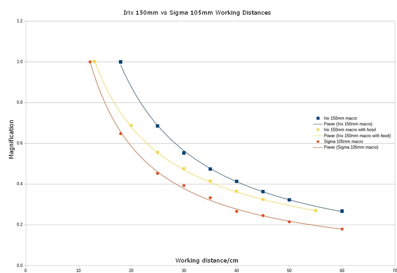

Due to focus breathing this lens doesn't give you any more working distance than the Pentax 100mm WA when you put a hood on. Also check the point about f/16 resolution in this post....
So all in all a bit pointless then :Due to focus breathing this lens doesn't give you any more working distance than the Pentax 100mm WA when you put a hood on.

Posted 18/02/2019 - 10:18
As promised, here's a graph of magnification vs working distance for the Irix 150 and Sigma 105. Strictly speaking, it's magnification relative to size at minimum focus distance. I've assumed for each lenses that magnification at its minimum focus distance is 1:1 as manufacturers claim. All done using a low tech, quick and dirty method involving a metre rule and a large bolt, so not high precision measurements, but good enough to show what's happening for those who like to know such things.
Photos still to come. Just recovering from weekend visit by daughter, 3 year old granddaughter, some pink rabbits and a couple of unicorns. Photography had to take 2nd place to entertaining the child.

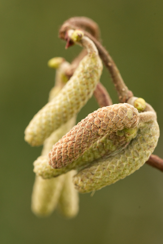

Posted 18/02/2019 - 11:30
And now for some pictures.
Catkins at f2.8, f5.6 and f11. Not 1:1, just a convenient subject for checking effect of varying aperture. Focussed on front of nearest catkin, background a long distance behind (relatively). Outdoors in shade. A still day but can't guarantee the catkins were perfectly still. K3 + Irix 150mm, tripod + 2 sec delay. DNG files, slight sharpening at raw, resize to 800px then sharpen (USM).
f2.8
f5.6
f11
f2.8
f5.6
f11

Working distance is not so straightforward. At minimum focus distance (1:1 magnification), front of lens to subject is about 18cm for the Irix, 12cm for the Sigma (my measurements). However, the front element of the Sigma is well set back from the front of the lens so I rarely use a lens hood. The front element of the Irix is not set back so its lens hood may be needed. Minimum working distance from front of hood to subject is about the same as for the Sigma without lens hood. Of course, as distance to subject increases and magnification decreases, the presence of the Irix lens hood becomes less significant.
