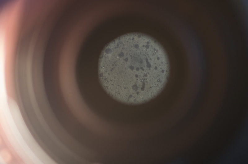

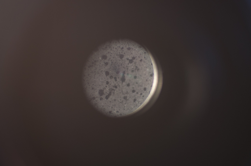

Armed with a torch I spent some time peering at my lenses (Sad I know!)and noticed the 35-70 had a problem. It appears to affect a lens element behind the front glass. It doesn't look like the fungus I've come across before.
Looking through the lens without the torch I didn't notice anything unusual.
I've taken a couple of pictures from the front and behind. Also attached a quick shot taken as a test image.
Is this fungus or a different problem?
