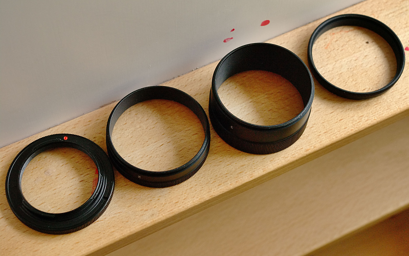

Relax, nothing off-topic or personal here! Its about stuck extension tubes . Following some of the advice I got on the thread asking about 'Pixels or Glass', wanting to take closer focused images, I got a set of 'Neewel' tubes from Amazon. First time with anything like this, so it was bound to go wrong
There the good and the bad - the good is that I was able to get shots very closely focused ans I think the quality is OK - I'll put a few shots us on another thread soon .... bad news is that one the mount rings has become stuck onto my 'M' 75-150 zoom - totally jammed.
Pictures below, but there are two mount rings, one with a small screw at the side which is the one I attached to the lens - the screw makes no difference. The aperture still works on the lens, although not 'auto-diaphragm - the lens remains fixed at the aperture on the ring and does not jump back to full open. So no 'stop down' metering, although I still get accurate readings via the green button, just a dark viewfinder at smaller apertures.
Is this functioning normal with extension tubes?
Heres the set, minus the jammed ring :

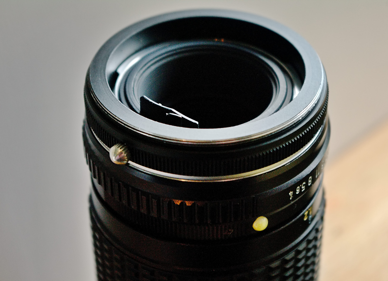

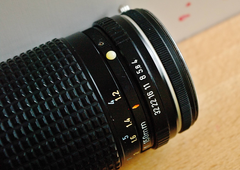

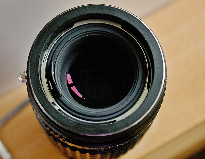

And heres the lens with the mount ring jammed :
I'm not panicking - the camera is fine (and the other ring goes on and of the camera OK) - and I can use the lens for the close-ups .... but its a nice lens and I would really like to have it back for normal shots! Any ideas very gratefully received.
doingthebobs
Posted 19/06/2014 - 21:37 Link
About the only thing that should catch is the lens release catch.
Looks a bit like the release catch(chrome knob) is under strain. You could try gently rotating the lens and mount in opposite directions, backwards and forwards, while operating the lens release catch. Just a thought, The lens release could be a pull operation rather than a push.
Of course you may have already done this and I may be completely wrong.
Bob
CMW
Posted 19/06/2014 - 21:39 Link
If you haven't already tried this, loop something suitable round the circumference and then clutching both ends of the material (rubber is best) together try to turn the ring. With the thin metals often used on these rings finger pressure on particular parts of the circumference can cause the ring to bind.
Good luck.
Regards, Christopher
ChristopherWheelerPhotography
gwing
The no-stopdown metering is completely normal Greg. If you buy the more expensive and harder to find 'auto' extension tubes you get stop down metering but as soon as you start reversing lenses you lose that again so the cheaper manual tubes aren't that great a disadvantage.
That silver knob on your extension tubes is the equivalent of the lens detach button on your camera body so you need to press/slide that and then jiggle the lens to detach it I guess. On cheap tubes the mechanics aren't as good as the camera body itself but I haven't had one that wouldn't release myself.
frob
Posted 19/06/2014 - 22:07 Link
My intense sympathy- I managed to get the connecting ring stuck on my K-r by cross threading it. Took me weeks to finally get it off. i hope you have more luck. The little knob pushes down away from the lens BTW.
Best wishes,
Rob
JohnX
Posted 19/06/2014 - 22:58 Link
It appears the little silver 'screw' is actually a button that operates a pin, so to release the pin you have to slide the silver button away from the lens, at the same time turning the ring to unlock it from the lens.
Edited by JohnX: 19/06/2014 - 22:59
andrewk
Posted 20/06/2014 - 00:56 Link
Nigel, in your last pic, you need to push the button towards the top of the pic and rotate the tubes anticlockwise - i.e. lift the pin, don't push it inwards.
Edited by andrewk: 20/06/2014 - 00:57
McGregNi
Posted 20/06/2014 - 02:01 Link
GOT IT !! Thank you all very much .... it was that little 'chrome knob' thing, that I didn't think was a knob at all - it is in fact a screw that come out - I was just adjusting it in and out to no effect, but as Andrew just said, it lifts up and pulls the pin up with it, therby releasing the ring. Great, I've got my lens back!
