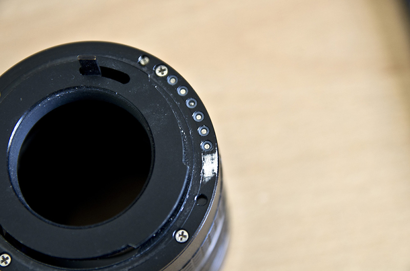

davidstorm wrote:
It's definitely the paint Nigel, it doesn't need investigation, it's the paint that's doing it! Just remove some with a scraper, or with a dremel type tool, you can't harm the tubes doing this as there's nothing to damage, just do it man and stop deliberating over it!!
It sounds like a plan to me. It's definitely the paint Nigel, it doesn't need investigation, it's the paint that's doing it! Just remove some with a scraper, or with a dremel type tool, you can't harm the tubes doing this as there's nothing to damage, just do it man and stop deliberating over it!!

Good question... Each tube has two levers, one short one long. The long one is connected to a spring running around half the diameter at the camera end. This long lever is pulled back to one side by the spring. The other small lever has no spring and just moves freely. This is the one that I found altered the ability to change the aperture when the lens was attached to the tube. Both levers on all tubes move freely and the springs work fine, nothing to suggest there is anything wrong with the tubes. I will try and scrape the paint around where the mount contacts are. ...
Nigel, can you confirm whether both the couplings (stop-down and aperture transmission) are free to move in all these tubes?
But I think that the small lever is being moved into the position that prevents aperture operation when mounted on the camera. Is it the case that having the contacts cleared of the paint will mean the lever will be moved into the other position when using the green button and firing the shutter, so allowing the lens to stop down at the same moment?

Thanks! I'll try that over the next couple of days, and see if I can match that up with the tubes I've got. I'm guessing it has to take away the paint that covers a specific contact on the lens mount. Thanks to everyone who has helped so much, I'm actually very much enjoying messing about with the tubes and lenses, its all been a great new experience, and hopefully will open up many more photographic potential to come.
Posted 02/07/2014 - 15:16
I have a set of Marumi K-A extension tubes and I had to scrape of the Anodizing on the bottom bayonet part. Anodizing is a very good insulator and it made the trouble. Once this was done the auto-diaphragm on my A lenses worked OK.
