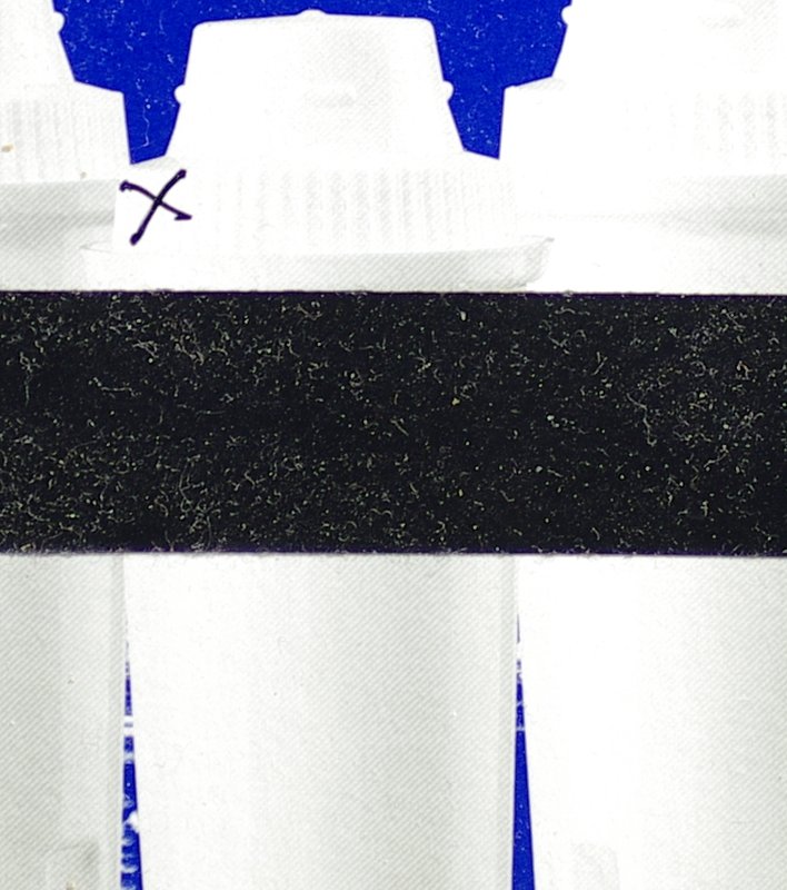

A dot screen printed cardboard box is excellent for focussuzzy,

testing. Interference with the dots causes them to appear
as diagonal lines when exactly in focus. I use this mostly
to check MF lenses. I also run a piece of black elecrician's
tape accross the box for AF. (Not shown here but I have a
piece vertical as well. I also leave it somewhere to
get dusty, because I can manual focus on the dust in LV.
This only works at certain distances usually about 1M.
A ruler clamped to an old piece of wood and plonked on top
of the box at 45deg with the 2" mark in line with the face
of the box gives an approx. indication of how far focus is
out. With some lenses there will be a colour change from
magenta to green at the focus point.
Does £100 in Kit Form sound reasonable
Equipment used: K-5 + Pentax_A 50mm f/2.8 Macro at f/2.8
