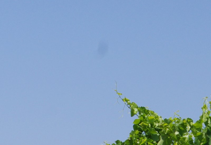

Try the sensor dust removal several times. Then a rocket blower. If still no success, then a cleaning kit may be needed. Others will follow with their recommendations. I've never had to use a cleaning kit, so can't help with that bit.

Hurray! It has gone. Was a tiny speck, and my makeshift removal attempt was to direct a jet of nitrogen (from a gas preservation system for wine) at it, which seemed to do the trick. Thanks for the advice.

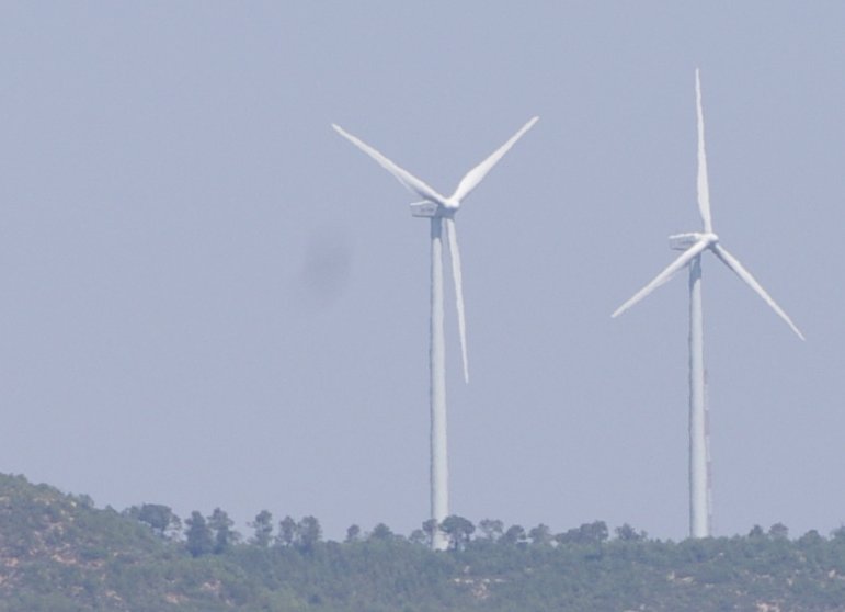

Examples plus crops below. It is about 1/5 way down the frame and central. What can I do about it?
