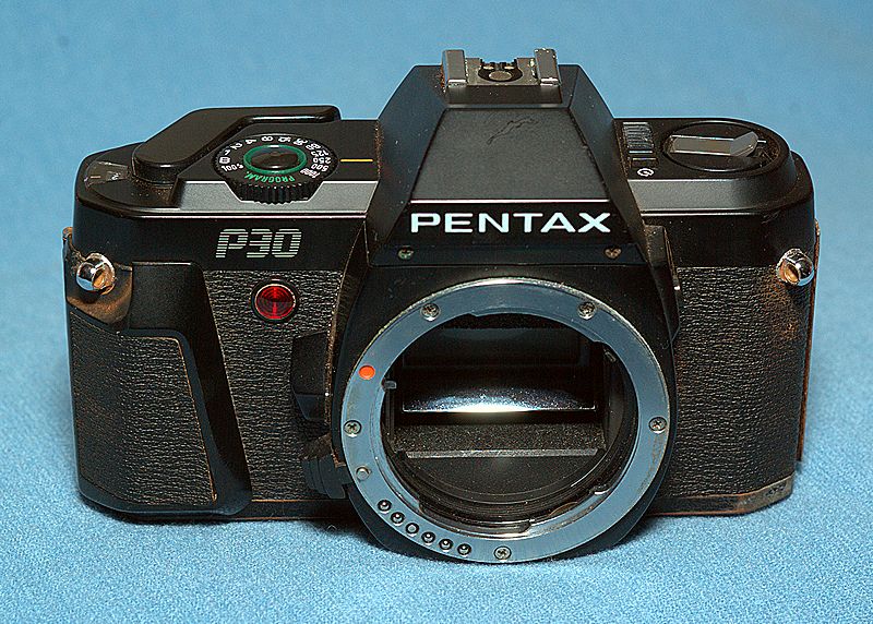

a latest 'Saved From The Dump' camera is a P30 with 2 lenses, one Pentax Zoom Takumar 'A' 28-80mm f3.5-4.5, one Vivitar Zoom 70-300mm f 4.2-5.8 , Cobra flash, Cobra Bag, Cokin and Jessop Filters BUT OH DEAR-- due to being 'in The Loft' for many years Camera is all Rusty along the back and the strap eyelits. I dumoed camera bag as it was filthy and torn , both lenses have FUNGUS and to get camera battery out I had to take off base-plate with JLS Screwdriver having put a minute amount of WD40 onto small rusty screw heads . I lubricated all the cogs and levers with minute amount of Sewing Machine oli, fitted fresh 1.5 V SR 44 batteries 'borrowed; from my 1970's KX and it 'creaked into Life ! '
Now I have the idea to emery paper off the RUST and paint on some black Chinese Lacquer that I have, but preliminary attempts with Emery paper have not taken off all the Rust. Any Advice ?

Try a Dremel-type tool with a fine wire-brush attachment then fine emery bands - but I suspect you will get through a "few" brushes and emergy bands before you get everything off.

Well, a friend told me about 'Hammerite Rust Removal Gel' from Halfords so I splashed out £5 odd and painted it on then after 'infusing' wiped it off as much as possible and painted on some black Chinese Lacquer. It look better. I then found that lenses were always 'stopped down' instead of being full aperture. I had a look and lubricated the moving ring inside the lens mount, then found the lever was stuck for the 'Depth of Field' so lubricated that and prised it up from stuck position. After working it lenses now 'Stop Down'. I also renewed light seal strips in camera back and P30 is very happy !
After Treatment Images attachedComment Image
