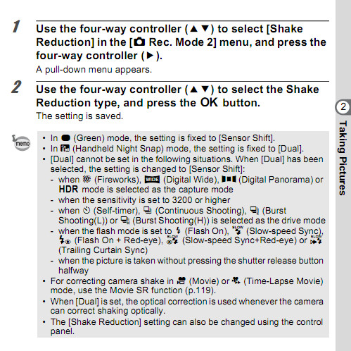

Thanks. My only options there are Sensor Shift or Off, not 'Dual'. Is yours different?
John K
Posted 16/05/2017 - 00:34
Posted 16/05/2017 - 00:38
Thanks again, I didn't think to look on the next page!!
Edit.. or maybe not. No dual option on my MX-1 anywhere.
Edit again!! I've set the auto ISO max from 3200 to 2500 and it now shows up. Why wasn't it just greyed out??
How can you set something when it doesn't show up?

Sensor Shift;
Dual (Sensor Shirt + Electronic correction);
or Off
Even the camera's advertising blurb boasts about this dual system
Dual shake-reduction system to assure sharp, blur-free images
The MX-1’s dual shake-reduction system couples the PENTAX-developed sensor-shift-type SR (Shake Reduction) mechanism with a digital SR mode to more effectively compensate for annoying camera shake. This hybrid system assures the photographer of sharp, blur-free images even under demanding shooting conditions prone to camera shake, such as when using a telephoto lens, shooting with incidental light only in poorly lit locations, or photographing sunset scenes.
I've been unable to find the Dual (Sensor Shirt + Electronic correction) setting in the menus. Am I alone in not having that 'Dual' option? I'm on version 1.00 and not been able to find a firmware update.
If that option really is there. where is its setting please?
