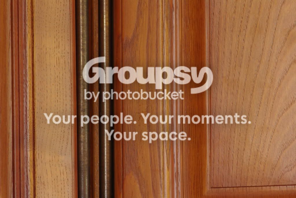

Posted 12/07/2010 - 16:13
I used my kitchen cupboards - the wood grain is quite good for checking sharpness. First, the 80-200mm at 200mm. I've posted links to avoid resizing the images:
http://i183.photobucket.com/albums/x21/Kingofthemountains/IMGP2811-2.jpg

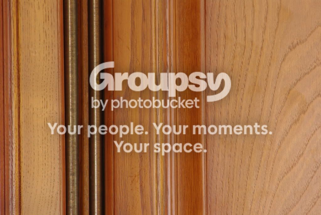

Second, the 200mm. Both shots taken at f8 with the same camera settings then uploaded:
http://i183.photobucket.com/albums/x21/Kingofthemountains/IMGP2813-2.jpg
Interestingly when I tried shooting with the 200mm in A mode (using Av and setting it to f the resulting image was darker than that produced by the same lens in M mode, set to f8 and using stop-down metering. Given that I had to use the latter with the 80-200mm anyway I decided to use it for both in the interests of fairness, although when I put the lens back into A mode the camera claimed that it was overexposing by 2ev.
I don't think there's much in it TBH. The A series is obviously easier to use, it's also a bit shorter and lighter than the zoom. They're pretty close in terms of image quality however, and if you use an LX, KX or MX you get the aperture in the viewfinder anyway!

Thanks Matt, Interesting. The 200mm A is the sharper there, but you wouldn't normally use it so close, so it's still worth doing another test at about 25m. Lenses sometimes give different results close up. Now that I think about it I think the 70-210mm zoom was like that, but at 25m the A and M were almost identical. The A was slightly better wide open.
