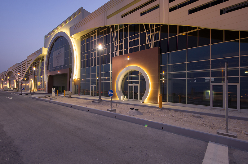

2523 posts
Here,
there,
everywhere
The distortion from the lens at 8-12mm looks quite complex, with distortion not even across the image. I can get round it manually, but it's very time consuming, and I'm using the lens on an architectural shoot, for which the client wants a minimum of 60 images. I need to use this lens, as the available space around the buildings is extremely limited in places by busy roads, and some shots are not possible at longer focal lengths. On some of the buildings (there's 5 spanning 7 miles) I can't get closer to the buildings than the pole you see in the foreground of the first shot, though I will have the use of access platforms to get to mid-building height.
The exif also doesn't show the focal length the lens was set at.
Here's a couple of examples to show the type of image I am dealing with. Does anyone know of another program that would correct the distortion if I can't do it in LR5?
