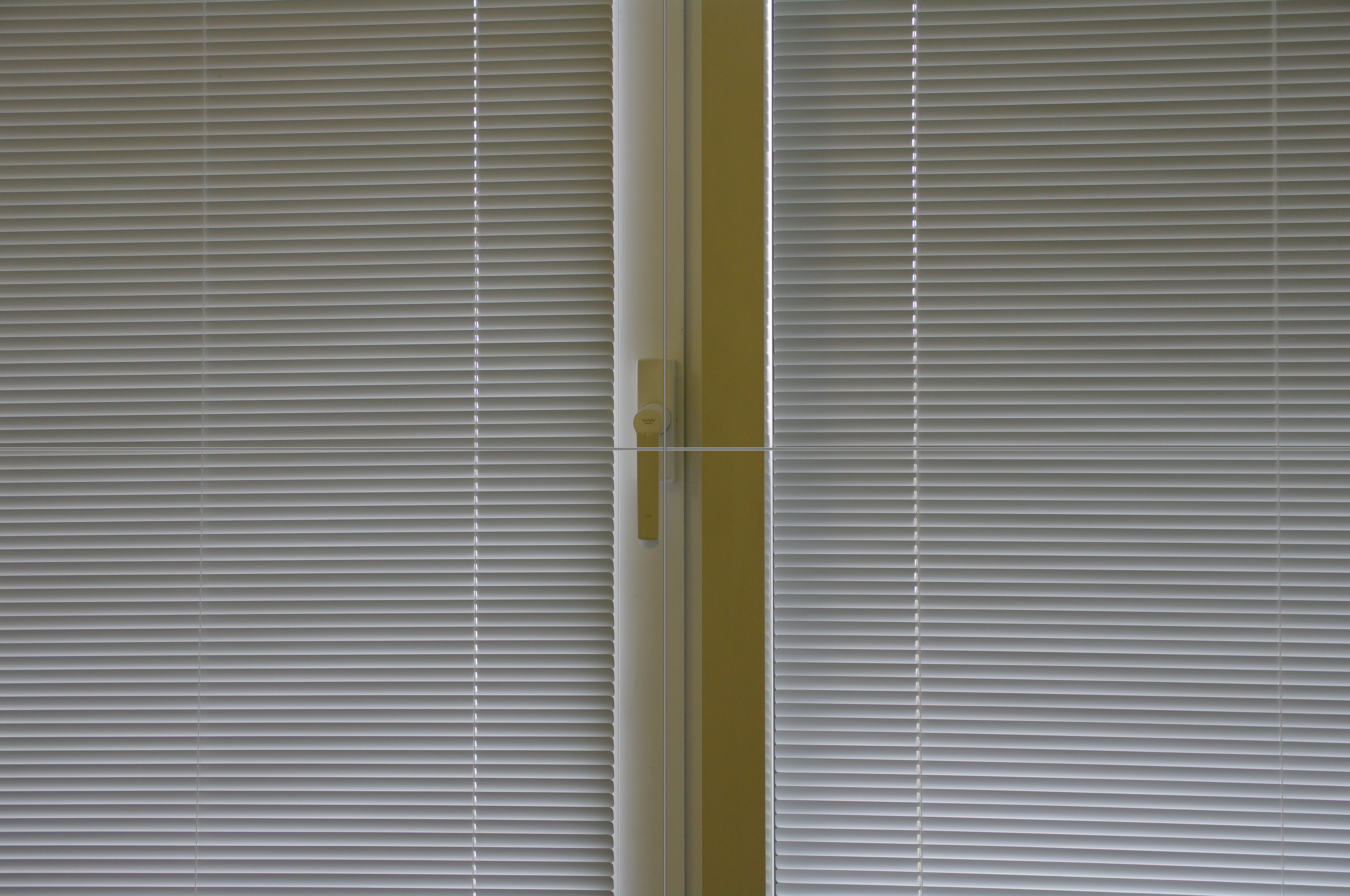

Ok... I'm going to throw a REAL spanner in the works here
First of all, I found out how to get an edited JPG back onto the camera so it will display it! Woohooo!
1. Go here: http://www.panasonic.com/business/projectors/ss_software.asp
2. Download "JPEG Converter [exe]" and install
3. This little tool saves a DCF compliant JPG to the folder of choice
I renamed the JPG files back to "IMGPxxxx.JPG" and saved to the SD card and the K20D displays them just fine
Now, I took a full res JPG shot of a boring scene, took it into Photoshop and put a black-white-black-white single pixel stripe. I did this horizontally and vertically. Ran it through the DCF converter and displayed on the K20D.
What I get is this:
1. x11 shows promise of 1:1, but vertical lines show a checkerboard pattern (presumably because of the arrangement of pixels in the LCD)
2. x14 is the first zoom to show an accurate 1:1. BUT there is the possibility of some aliasing on the horizontal stripe only. Odd!
3. x16 is really fuzzed up with aliasing issues
4. x19 shows some fuzzing
5. x23 and above clearly and reliably shows the single pixel lines... but it's difficult at these zooms to separate ISO noise from real detail.
My conclusion (at least from this test) - use x11 or x14!
I'm happy to email the 10Mb JPG file if anyone wants to test it out... or you can follow the same procedure as me and see what you come up with!
EDIT: added extra observation about x11.
Matt

Matt, please send me the jpg so I can have a go and check it.Ok... I'm going to throw a REAL spanner in the works here

Whats the best way for you to send me please? do let me know

Hi Amin,
You can download it from here:
http://www.photon.me.uk/pu/K20D_FullZoomTest_IMGP4001.JPG
Be warned - it's 10Mb!
Hopefully you can download it and rename it to just "IMGPxxxx.JPG" and stuff in an appropriate directory on your card (usually DCIM, but may be date related depending on your custom settings on the K20D)
Let me know what you find out!
Matt
