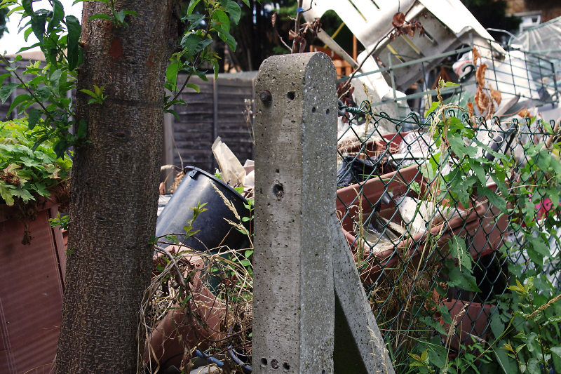

And these are just junk in next door's back garden. I aimed at the hole halfway up the concrete post. My own saved pictures show it is in focus with the K10D and there is far better detail whereas with the K5 it is definitely not in focus. When viewed at 100% size the air holes in the concrete and the hexagonal nut at the top are nice and clear with the K10D but the K5 has given a blurred image.
Above: K5 & 18-55, 35mm @ f7.1
Above: K10D & 16-45, 34mm & f7.1
I've now tried the 16-45 & 18-55 on the K5 and there is no difference. Images seem too bright and lack detail.

Just looks to me like the K5 is over exposing a stop for some reason.
Pentaxophile
Posted 11/08/2013 - 17:17 Link
Re the colour and contrast, have you tried a different picture setting or adjusted the contrast / colour in the one you are using? It could be that the K5 has a different look in 'Natural'.
Have you got highlight/shadow compensation on? Those will reduce contrast.
I've applied some curves and warming filter in PS to make the image look a little closer to the K10 image:
Re sharpness, the images shot over f11 will be softened due to diffraction. In the f7.1 image, I notice that the K5 photo is focussed slightly behind the K10 image (look at the fence in both shots - it's still in focus on the extreme right hand side on the K5 shot, whereas in th eK10 shot it starts to drift out of focus)... You may have focussed imprecisely, or your lens focus settings may need adjusting.
I went from a K10 to a K30, and intitially images with my Tamron 17-50mm were slightly backfocussed.
Also, the K5 is 16MP and the K10 is 10MP... you may need to apply a different amount of sharpening to your resized shots.
johnriley
Posted 11/08/2013 - 17:21 Link
Just apply some minus exposure compensation to the K-5 shots and you should be fine. The K10D under-exposes compared to the K-5, or, conversely, the K-5 over-exposes compared to the K10D.

Thanks for the comments. I was doing the same images with the post last week and again yesterday and got the same results so I know I wasn't focusing incorrectly. Both cameras have had both lenses and it hasn't made a difference. I should point out the K5 was on 10M size as it always is so there's little difference in the real size. Both are usually set to bright but yesterday I changed it to natural. K5 had been on lowest level shadow correction when I noticed the difference between it & K10D so I took that off before doing these photos but didn't see an improvement. Maybe K5 is over-exposing but there's also the colour, sharpness and detail which I have seen compacts do better at and I should not be trying to get a K5 to be as good as them! I don't have Photoshop anyway. I will have to decide what to do with the K5 because knowing that the K10D can take better pictures, it will be the one I take out.

If you set them both to 10MP you might as well use the K10D if you're happier with it. Maybe even keep a look out for another?

1. Check your camera/lens for backfocussing and make the required adjustement.
2. Perhaps try dialing in some - exposure compensation and adapt your practise to a metering system which is less prone to underexpose than the K10D (I found it took a while to get out of habits I had got into with the K10D because of that camera's propensity to be fooled into underexposing by bright skies etc).
3. Try out the different image tone settings or adjust the one you have (+sharpening +contrast +saturation perhaps?) These settings are almost infinitely tweakable!
4. Shoot at native 16MP not 10MP otherwise you aren't getting the best detail out of the camera. I'm not sure, but perhaps the in-camera resizing is softening your images? Certainly you are ditching a lot of detail.
As I said I switched from a K10 to a K30 (similar to the K5) recently. For a while it took a while to get used to the K30's output. I tweaked about with the image tone settings and am now happy with it, and after using it for 'serious shooting', rather than 'test shots', much prefer it to the K10D.
All these cameras benefit from using some sort of post processing software to tweak the images, they do not produce the sort of oversharpened, oversaturated 'Facebook ready' shots you will get from most compacts. You certainly ought to resize your images and then sharpen them yourself, rather than let websites resize them for you.
