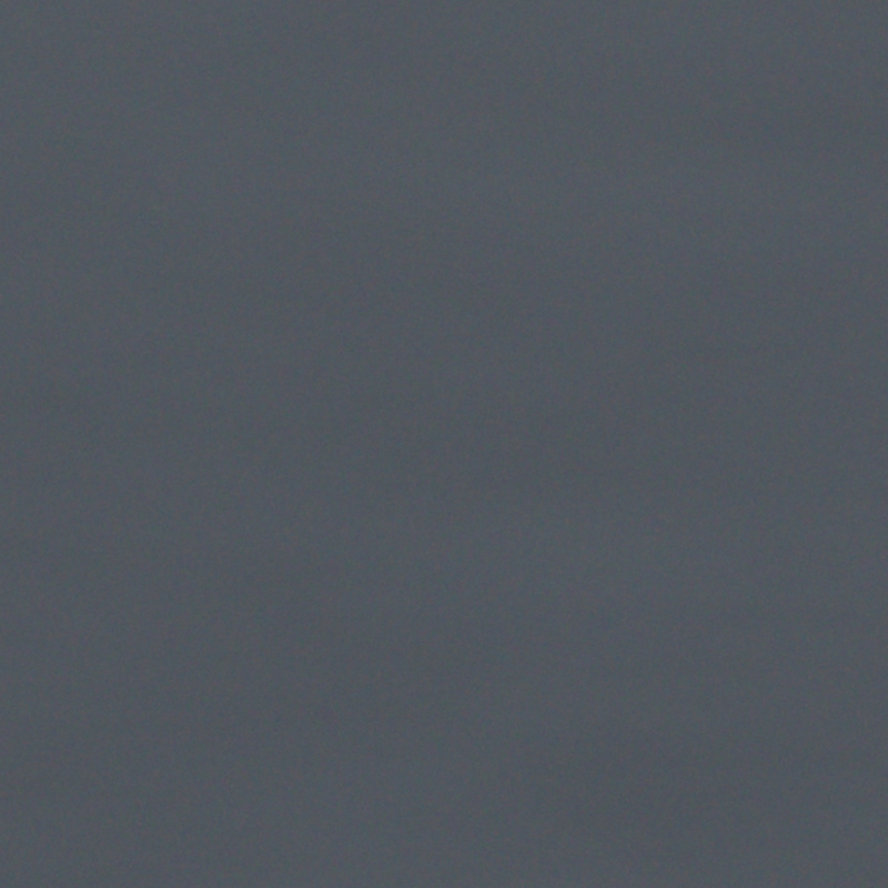

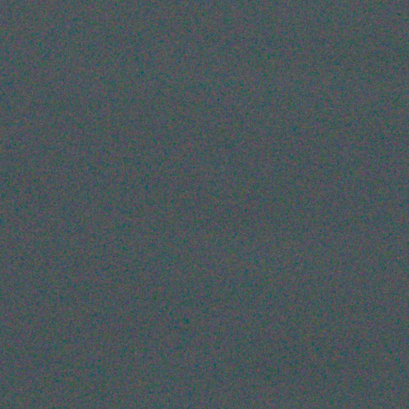

Here's the results of a test done this evening with the K3 + 16-85mm (a very good lens) to show signal to noise ratio in practice. Taken outside, bright but overcast, uniform light. Subject was a neutral (very dark grey) board. All at ISO 200 and f8, defocussed to minimise the effect of imperfections of the matt painted surface. All images are 800x800 pixel crops so the forum images should show exact pixels. RAW (DNG) files, no noise reduction in camera or in post processing (with Affinity Photo), converted to highest quality jpegs for the forum.
Here's the base image. Camera chose 1/25sec to give a mid-grey (as it should). Some noise apparent but not much and easy to remove in post processing (the default noise reduction in Affinity Photo does a good job).
Now an image underexposed by 4 stops (at 1/400sec) with + 4 stops added in post processing to bring the average brightness up to base level. Although the overall brightness is the same as the base image, there's a lot more noise. That's because the noise from the sensor has been increased by 4 stops in post processing. More difficult to remove in a 'real' picture because there's more of it competing with the detail that you'd want to retain (the software wouldn't know what is noise and what is 'real' detail).

In a real picture, the same level of noise will be present everywhere. However, it will be more intrusive in darker areas because there is less light to mask it. It's up to you how much noise is acceptable and to ensure that it is below that level in the final image. Noise reduction in camera or post processing software is good, but it can never know whether the random specks in a shadow or dark area are sensor noise or vital detail that you need to see.
I hope that makes sense!
