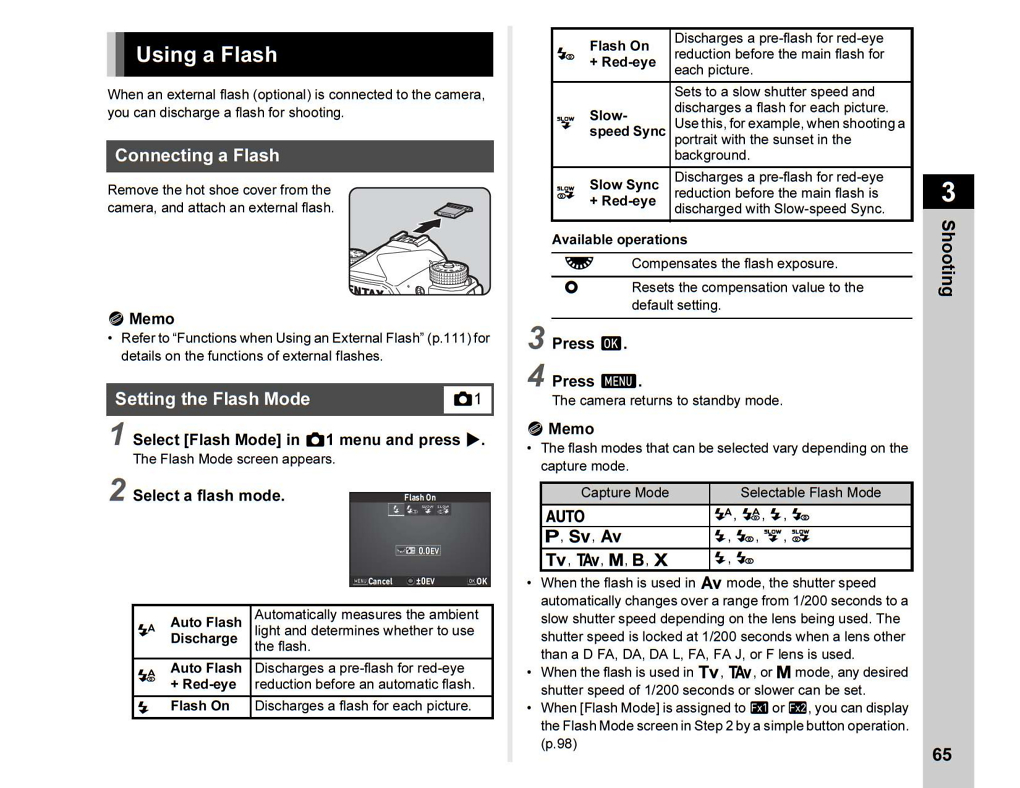

It's stuck on m and the flash symbol on the rear screen and turning the wheel to tav or any other the m and symbol it stays the same

My K1is exactly the same. I've just assumed that's how it was meant to be. I don't reckon this is a fault, just a "quirk" in the software, deliberate IMO.
It does make life simpler when using a flash. Connect the flash and switch the flash on if you want to take a flash shot and then switch the flash off if you don't want a flash shot. Quick and easy, saves messing about in the camera menu.

1.Check your settings are not locked.
2. There was an issue with early K-1's where the mode dial is locked on M mode.
I suspect this is your issue. Nothing to do with flash settings.
