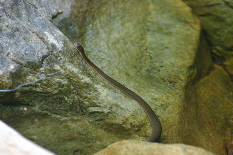

The snake is actually in the water. 123mm f4.5 Auto focus set for spot with Center (V) selected
