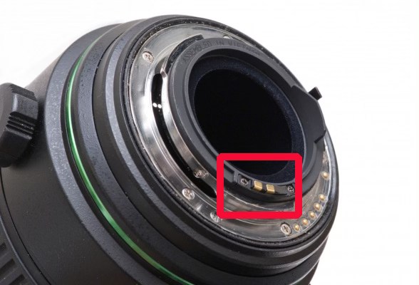

Gold Contacts Replacement
Posted 29/08/2024 - 09:30
Correction - Its not a ribbon cable but rather Male/Female plug with the contact metal as seen here.
https://youtu.be/10RUItX9zZw?si=3RjRDOQzgLjKOaUL&t=310

Posted 30/08/2024 - 07:16 - Helpful Comment
As you say looks a fairly straightforward fix if you can source the parts. Have you tried Asahi Photo they might have some or know where to source them, they do some modern lens repairs so worth a try.
Posted 30/08/2024 - 08:04 - Helpful Comment
I would suggest contacting J Pye. If you explain the situation to them, they may agree to sell you the parts. I have had success in the past with this approach.
Regards - Steve
Regards - Steve
Posted 30/08/2024 - 09:33
Yeah, I have been intouch, they unfortunately cant help and recommended J Pye - Which I have done but not had any response yet from them.

It takes a lot of perseverance to get a response from them. I suspect they have very few repair staff from my own experiences.
Posted 01/09/2024 - 09:39 - Helpful Comment
If the contacts on both lenses are identical, there's a chance that contacts from other lenses will also be the same size. Maybe a search on eBay for Pentax 'spares or repairs' lenses might allow you to get the spares yourself? You obviously have been ok taking the mounts off.
In the meantime, can you not at least repair one lens yourself using the good contact from the other?
Posted 01/09/2024 - 12:56 - Helpful Comment
As above, a donor DA 18-135, DA 17-70 or DA 18-270 (these are likely the cheapest) or spares and repairs lens may be the only option if the part is not available.
A google search for Pentax Power Contact 48200-0M291 shows next to no entries, where you might expect pages of them for anything else.
Fingers crossed for Pye for now, I have found them to be very good in the past.
Posted 02/09/2024 - 14:25
Hey folks, thanks for the replies. I'm chasing on JP and Ricoh. Failing that, probably worth me posting on the Pentax centric Facebook groups, might be someone who has spares/repairs. Looking on ebay, prices for spares/repairs lenses are cost prohibitive.
Thank you for the model recommendations Kevin, thats helps a lot! Cheers.
Only other option, mate has a 3d printer, might be able to fabricate something.
I'll keeps folk posted.
Geoff.

Posted 02/09/2024 - 14:26
Unfortunately not, the module is injected plastic around the brass contact, so there is no simple way to extract the brass and re-insert a new bit. I have tried

Posted 03/09/2024 - 14:28
Right, progress is being made. JPye have been in touch and the replacement part x2 have been paid for
All being well should be back up and running before the weekend. If its of any use or help to people...
The Part Number is 481200M291
- If your in the USA then these guys list that part too
https://uscamera.com/product/pentax48120-0m291-power-contact/
Geoff
Geoff

Posted 03/09/2024 - 14:40 - Helpful Comment
Great news Geoff. These are expensive lenses so it is good to know you are not stuck on this.
We're the parts costly?
Posted 03/09/2024 - 14:58
Thanks, and thankfully not. I was quoted £25 + VAT + Shipping, so all in around £30 total for x2 parts. Which is fine, I use these lenses extensively and although the lenses still function in a manual sense, my K1 is exhibiting assorts of quirks in operation, with them attached.

Posted 04/09/2024 - 20:03
Evening folks, took delivery of the spare parts this afternoon and roughly 90 seconds per lenslater they are now both up and running again. Now it might be coincidence, pattern matching or just wishful thinking but the AF feels noticeably snappier on both lenses before the AF contacts breaking. I'm back in the game - i hope the information in the thread above also helps someone else in the future who might have this very same issue.

I have checked several of my other lenses and these appear interchangeable, i'm quite sure there is just a ribbon cable underneath. Has anyone ever had this issue?
As a thought . does any one have an old spare or repair lens that that has this part they would be willing to sell, Im sure this is a diy job of removing the screws detaching the ribbon cable and replacing the part., DIY job.
Thanks
Geoff
