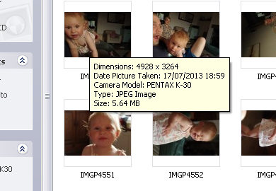

If the JPG file was 156kB then it probably was a tiny image!
Sounds like your editing software has produced an emailable image rather than a printable image
Pixel dimensions is the criteria for printing.

What would matter is the total amount of pixel data. So long as the camera had been set to its maximum 'resolution' setting, there will be plenty of pixel data in total for all standard print outputs, at least A3 I'd have thought.
What should happen is that the print service's software will adjust the file to give the best PPI figure to match the ideal DPI for the actual print -we don't really need to bother with these details I believe, unless we are printing our own shots at home on an inkjet machine.
Unless there was an issue with the amount of 'total pixel data' suppled in the file, (for example there was not enough for the requested print sizes to be printed at good quality), I don't understand why the printer is questioning the OPs 'DPI' figure (they mean PPI, right?)
Louise, just check that your K30 is set to its maximum resolution setting (that would be 16mp is that right?) - your shots will then be recording the maximum amount of pixel data, and any print service should be able to output big prints - the 'DPI' (PPI) of the files from the camera should not matter at all.
If you can't get a clear explanation from this particular print service of what the problem is for them, then just send your shots somewhere else.
