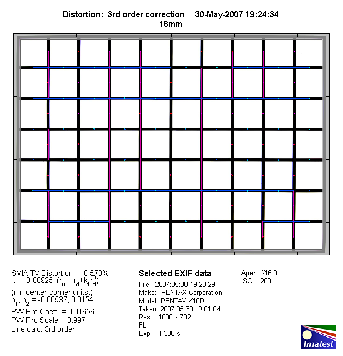

The 16-45mm is quite reasonable, but has more distortion than the 12-24mm. The 17-70mm I have no experience of.
Posted 02/04/2010 - 23:53
Posted 02/04/2010 - 23:59
So the humble kit lens out performs the 16-50 and the 17-70 in terms of barrel distortion... but as John said, the 12-24 outshines them all. Fascinating.

Kris Don't forget that the DA*16-50 is a f/2.8 lens so the lens elements are wider/bigger maybe that has something to do with it?
Also the DA12-24 is at the centre of his focal length so you should not really compare the how good the lens is with that data because all the other lenses have almost no barrel distortion over the 24mm.
The data was taken from photozone.de so if you want to see the other focal lengths go ahead.
