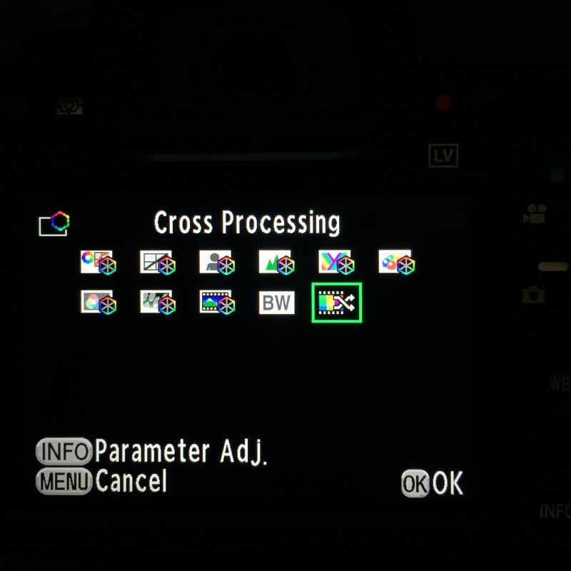

This does look like some strange rendering enabled. By JPG settings I meant image setting - those that allow you to select rendering presets for the jpg engine. They are accessible via the pad at the back. On K3 it's the button on the right. Should be in the same position on the K5? The interface looks like that:
Just pick one of regular ones - so natural/landscape etc. Each individual preset can be further adjusted so I'd make sure these settings are at their defaults as well.

Posted 01/04/2016 - 11:05
The EXIF data shows.....
1st image: Image Tone=Bright; White Balance=Auto; White Balance Shift=0
2nd image: Image Tone=Bleach bypass; White Balance=Flash; White Balance Shift=A7 (red)
.....presumably causing the red toning.
Cheers.
Philip
Cheers.
Philip
Posted 01/04/2016 - 11:15
I had the same problem with my K5, it turned out I'd somehow managed to switch to 'Bleach bypass' in the custom settings (button on the right of the control pad)
I just switched back to 'Natural' and all has been fine since
Regards,
Michael
Michael
Posted 01/04/2016 - 13:07
I just switched back to 'Natural' and all has been fine since .
That fixed it. thanks to all of you for your info and help.I had the same problem with my K5, it turned out I'd somehow managed to switch to 'Bleach bypass' in the custom settings (button on the right of the control pad)
I thought I had to buy a new camera. I never ever used this button before, but must have accidently touched it and altered the settings.
Thanks again, all of you.
Regards, Horst
