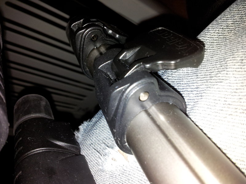

There isn't a nut, there is a screw thing that has no bit for you to screw tighter so I can't do anything (you can tell by my vocabulary that I come from a long line of mechanical engineers).

There could be a pin acting as a hinge. Check where the pin is fixed both on the lever and on the leg; you're looking for cracks in the plastic.
OR, if you could take and post a good quality photo of the lock?

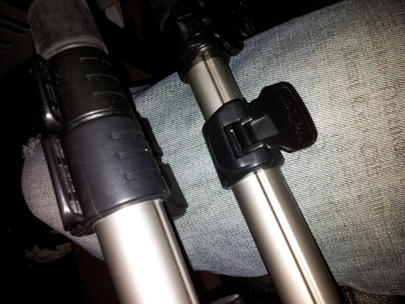

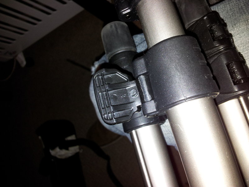

I think I may have solved it.. I removed the defective leg, left it wedged shut on top of a radiator to heat the plastic.. and keeping it wedged shut then dunked it into some ice water 1hr later.
So far, I've dried it off and it seems to be locking fine (if a little loosely), the clip doesn't snap confidently as it used to, but at least its shut.. will keep you posted..

I have a problem with my Velbon Sherpa 600R - one of the clip locks won't keep shut. It keeps springing back up and as a result the legs won't stay locked.. it would matter less (though still annoying) if it was on the lower leg, but it's on the top one..
I have Velbon a ring and they said they won't repair it under warranty because i don't have proof of purchase (second hand), and since it's still in such good nick, I can't really justify buying another tripod.. Any help/ ideas?
I have washed it (it's been in the sea/sand), dried it, relubed it, etc etc..
