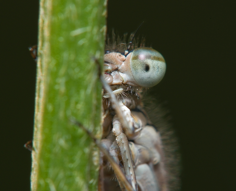

There is noticable camera shake David, and the flash could do with being diffused a bit more as there are 'hot spots'.
A little tip - when focusing I focus into the creature rather than just on the the bit closest to the lens, that gives a bit more DOF. (not sure if that makes sense 'tis fdifficult to explain)
Good idea to practise before the Nikkor arrives as that's a lot sharper and will pick up technique errors more than the 1.7.
Have fun with it.

Anything worth doing is usually not easy Nigel! Also, if it's hard it follows that not many people do it, so I am cool with it being a steep curve!Thats a very steep curve David
I've been practicing hard at macro for several years, my problem before was that I wasn't using the right kit. The recent posts about butchered zooms etc. have really set me off down a path and I won't stop until I consider my shots worthy of comparison with the best.
Also, as mentioned in my original post, I'm not interested in the 'put it in the fridge', 'shoot it indoors' or 'shoot it dead and stack it' approach, I want only to take pictures of these creatures in their natural environment with all that entails.

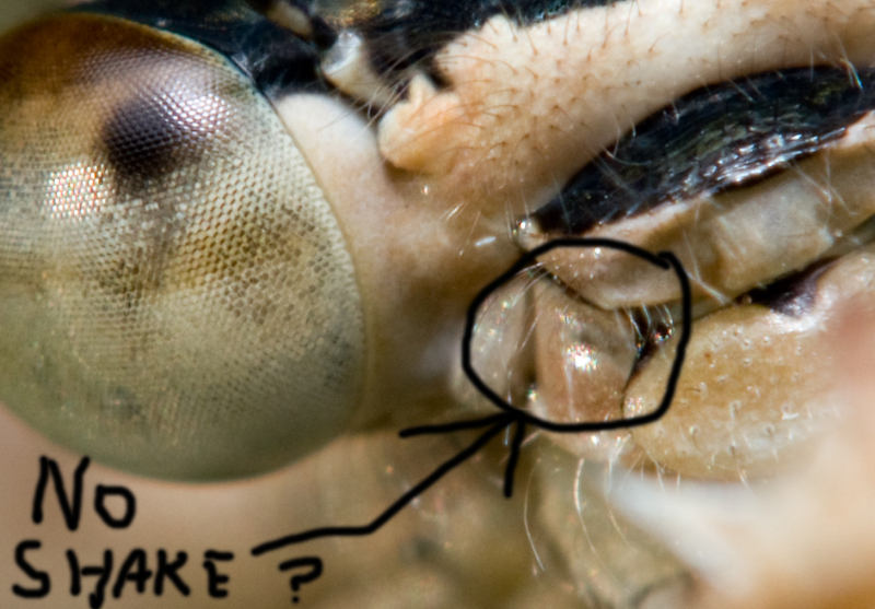

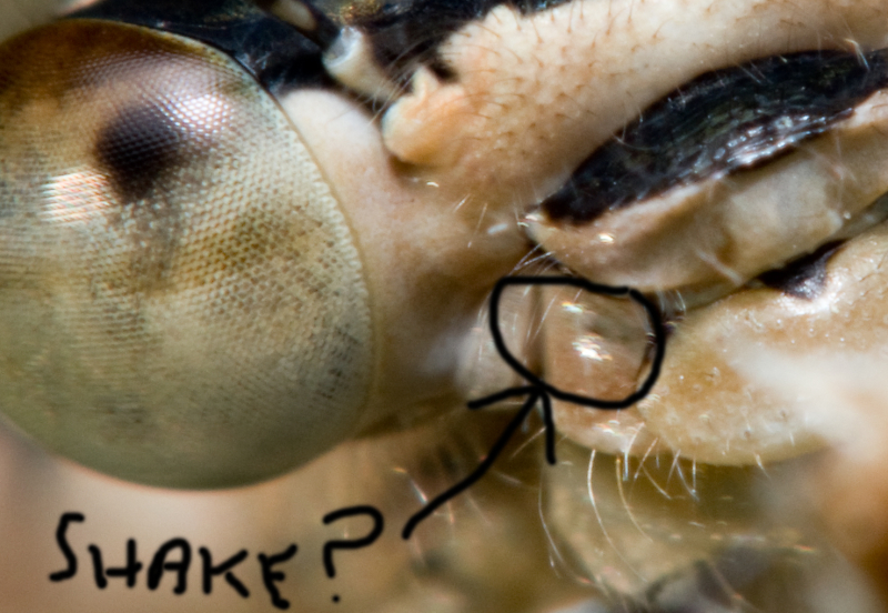

Hats off to Charlotte! I think I can now see what she means about camera shake. Take the first image above and compare it with a similar one shot just before, that I haven't posted here. I've cropped the same area and drawn on it where I think there is evidence of movement. However, I don't think this is camera shake, it is probably due to the wind blowing the stem back forth as the movement indicated matches exactly the movement of the stem I was seeing as I tried to shoot these images:
No Movement (from a shot not posted here):
Movement (crop of first image posted above):
Charlotte's observation demonstrates to me how critical I need to be of the quality of my shots. Thanks Charlotte!
Also, the observations about 'hot spots' are correct, but after having re-checked this I think it is because I had the power turned up too high on the flashgun. I've checked some from last night with the power set lower and there are no hot spots on these, so this is due to 'pilot error' rather than my softbox I think! I'll try next time a lower power and also add some more diffusion to the softbox.

Thanks guys and girls for your feedback, I've been working hard on this and it's good to know I might be getting somewhere!
Dismantling and re-assembling the 28-80 was not a simple task, unless you are an expert in lens construction it can be a bit daunting and is 50/50 whether you end up with something that still works. Surprisingly, the FA28-80, which was to all intents and purposes a 'Kit lens' was very well constructed with mostly metal parts which required a fair amount of drilling to get some of the lens elements out. Luckily, I ended up with a completely empty tube with a working aperture!

Hi Mike, the working distance on these is very small indeed, probably only around 2 centimetres with the reversed Pentax-A 50mm F1.7. This makes it quite difficult to stop the insects from flying off, in particular the Damselflies.Not bad at all,how close are you having to get with these shots David?

Please let me know what you think, especially in comparison to recent images I posted, which took a bit of a battering!
All shots with the K-3, a butchered FA28-80 zoom, a reversed Pentax-A 50mm F1.7, a Neewer TT560 Speedlite manual flashgun attached to the hotshoe and a home-made softbox, cobbled together from a 2.5 litre screenwash bottle (the rectangular type), a Pringles Tube, tissue paper and some Duck Tape. The softbox has made a massive difference to the lighting and avoids the black backgrounds on most shots, whilst spreading the light very well. The zoom is set to F32, the reversed lens to F1.7, based on excellent advice from the aforementioned PU Members.
Edit: I forgot to mention, please bear in mind these are all shot 'in the wild' so to speak, in breezy and dark outdoor conditions, with the stems of the plants waving about quite a bit. With this level of magnification, this makes it extremely difficult to get sharp, in focus shots.
