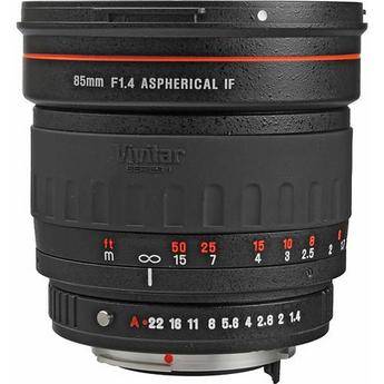

Samyang Lenses?
Joe S
Posted 20/07/2009 - 14:57 Link
Hi there!
I'm suffering a bit from LBA at the moment and surfing the bay for 85mms I stumbled upon a Samyang 85mm at a reasable price. Now, I don't need it (fortunate enough to have a 77 ltd and I primarily wanted to find out what my old 85mm Pentax could be worth) but the Samyang looked fine and further searching showed there's also a fisheye and a 500mm tele. A fisheye could be fun
Anybody know these lenses? I guess they are rebranded "somethings". Focus is manual and that't perfectly fine with me.
Edit: Also by the name "Falcon"
Hi. My name is Joel and I'm a travelholic.
Stolen kit: Pentax K7 #3428965 and Pentax FA 43mm #0028350
Edited by Joe S: 20/07/2009 - 15:01
johnriley
Posted 20/07/2009 - 14:59 Link
Is the the fairly new 85mm f1.4 that's appearing under various names? Of so, it does look tempting at the prices being offered.
I haven't seen a test of it yet - anyone know where there is one?
Edited by johnriley: 20/07/2009 - 15:10
Joe S
Posted 20/07/2009 - 15:03 Link
Yes John, that's the one. Try have a look at the fisheye as well.
Hi. My name is Joel and I'm a travelholic.
Stolen kit: Pentax K7 #3428965 and Pentax FA 43mm #0028350
Malo1961
Posted 20/07/2009 - 15:10 Link
johnriley wrote:
I haven't seen a test of it yet - anyone know where there is one?
Here is one. And here is another. For the money, you can't get wrong with it, I think.
Martin.
Best regards,
Martin.
Curious about my photography?? Just Follow the Light.
johnriley
Posted 20/07/2009 - 15:16 Link
Thanks Martin, very interesting. Seeing I can't afford a Pentax 85mm f1.4, I might well be tempted by this lens as a portrait lens.
Malo1961
Posted 20/07/2009 - 15:29 Link
At that price it is a no brainer. The next viable alternative in line would be this. But that is a whole different ball game. Price and quality wise. Still.....cheaper as the Pentax equivalents (MF and AF)
Martin.
Best regards,
Martin.
Curious about my photography?? Just Follow the Light.
Mike-P
Posted 20/07/2009 - 15:55 Link
I also am really tempted by this lens, it comes under a few brand names including Vivitar.
greynolds999
Posted 20/07/2009 - 16:49 Link
johnriley wrote:
Thanks Martin, very interesting. Seeing I can't afford a Pentax 85mm f1.4, I might well be tempted by this lens as a portrait lens.
I assumed you got all the free Pentax gear you could eat!
johnriley
Posted 20/07/2009 - 17:11 Link
Afraid not. Nothing.....
Anvh
Posted 20/07/2009 - 17:23 Link
Didn't knew that brand, they also made some Vivitar's
Vivitar 85mm f/1.4 Asphereical IF is made by Samyang so is probable the same lens.
Actual all current vivitar lenses are Samyang lenses.
They have a 500mm f/8 mirror lens
800mm f/8 mirror lens
650-1300mm f/8-16
Don't know if the vivitar branded ones are cheaper then Samyang?
Samyang made before that lenses under the name Polar:
800mm f8 Reflex
85mm f1.4 Aspherical IF
So most likely that 85mm is also the same so good luck hunting down which one is cheaper.
Stefan
K10D, K5
AF-540FGZ
Edited by Anvh: 20/07/2009 - 17:24
Malo1961
Posted 20/07/2009 - 18:09 Link
The Vivitar seems the only one without A contacts.
They other two have them (so more convenient) but....It isn't always advertised by the seller. So you better check it out, before buying.
Either way....for the money it seems incredible value. 199 GBP for you in the UK.
Martin.
Best regards,
Martin.
Curious about my photography?? Just Follow the Light.
Edited by Malo1961: 20/07/2009 - 18:13
Anvh
Posted 20/07/2009 - 18:31 Link
For you Martin, the K-mount version link
Stefan
K10D, K5
AF-540FGZ
Edited by Anvh: 20/07/2009 - 18:34
Malo1961
Posted 20/07/2009 - 18:38 Link
Thanks Stefan,
The seem to change specs faster as a normal human being changes underwear.
I am really considering one of these. Looks like a fun lens to use.
Martin.
Best regards,
Martin.
Curious about my photography?? Just Follow the Light.
Anvh
Posted 20/07/2009 - 18:48 Link
The one on the first photo is probable Nikon model or something
Here a photo from the Pentaxforum you linked to from the specs of the Samyang
These come from Vivitar site.
Filter Size 72mm (front mount)
Minumum Focus Distance 1.0m (3.3ft)
Focus Control single focal lens
Angle of View 28.3°
Groups/Elements 7/9
Length 71.2mm
Max. Diameter 76mm
Weight 510g
everything is the same except weight and length but are very close.
On the pentax forum they said this
As near as I can tell from pictures on the internet and the Vivitar/Sakar press release, this lens is the same as the Polar, Sakar, Walimex and new Vivitar Series 1 lenses.
The lens looks surely very good, certainly for that money.
Here is another review that put it against the Nikon lens
link
Stefan
K10D, K5
AF-540FGZ
Anvh
Posted 20/07/2009 - 18:56 Link
Mike-P wrote:
I also am really tempted by this lens, it comes under a few brand names including Vivitar.
You already said that almost 2 months ago link
ps. finally found their website link
Someone has an idea how their mirror lenses are?
Stefan
K10D, K5
AF-540FGZ
Edited by Anvh: 20/07/2009 - 19:04
