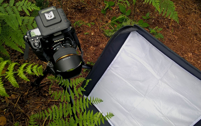

I placed a Cactus RF60 flash into the softbox and controlled it with a Cactus V6 transceiver .... I used a radio trigger system because I was placing the softbox directly on the ground and the flash would not be in line-of-sight to the camera. In fact the flash was often buried in the undergrowth ......

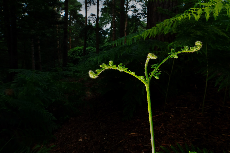

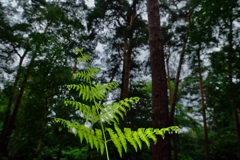

I used manual camera exposure mode and controlled the ambient background brightness with shutter speed, and the foreground flash-lit 'subjects' were controlled with flash power control directly from the V6 on the hotshoe. I enjoyed playing around with the lighting balance between the two, making the subject stand out boldly against the background or going for more of a blend of the lighting .....
In that sequence the exposure time was reduced step by step, progressively darkening the background while the flash-lit parts remained consistently exposed.
In the next sequence, the first shot is without flash ....
Then this one aims for a balance between the flash-lit fern and background, just enough to bring out the fern a little .....
And this last one pulls the background exposure right down to allow a more dramatic effect ....

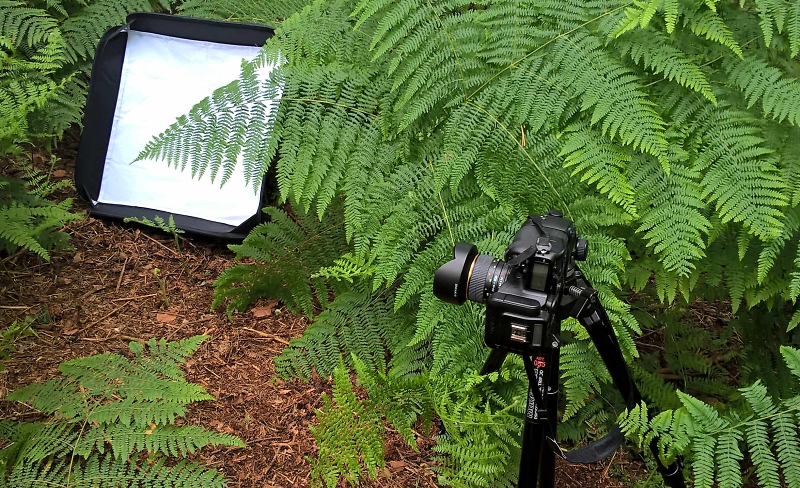

This was the set-up ...

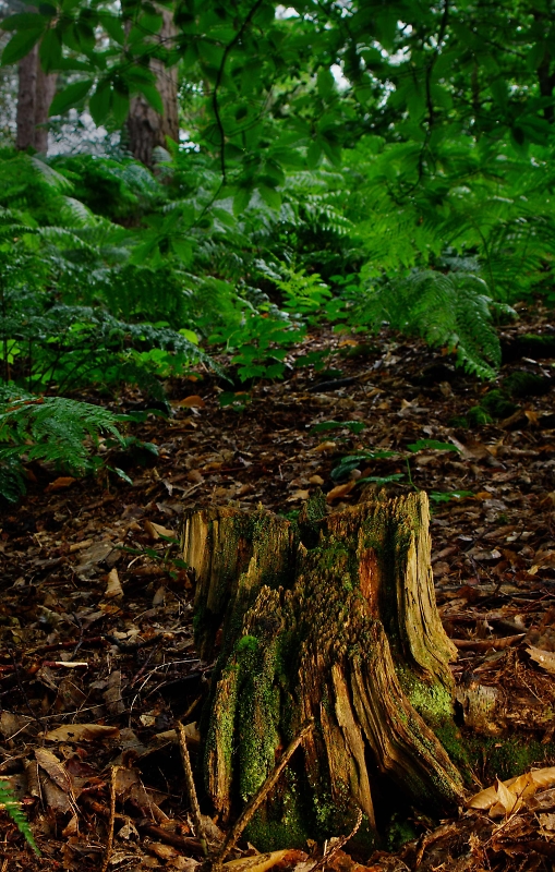

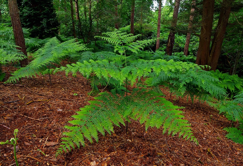

Here's a couple more examples where the flash helped to bring some much needed extra light into the foreground .....

Hi Richard, thanks .... Yes, all but the second to last are with the Samyang 14mm . That other one is with the F35-70.

Great stuff. The first and last look to have the best balance to me.
Watch out for your sky tho', looks like you've been quite bold with the 'whites' slider in post; pulling the highlights down, but it looks unatural. The sky would (and should) be burnt out in this situation I think.
This greyness has affected the highlights on the background leaves too.

Thanks also Andy and Mark .... I can always recommend the Cactus flash products, they are reliable, practical and get the job done. And soon we will have the V6II offering radio HSS for Pentax!
Mark, I do tend to try and avoid distracting sky highlights in my wood shots, but I guess I've turned the summer down too much here! DR is the big challenge .... Perhaps this gives me yet another good reason to start planning for a K1 ...
