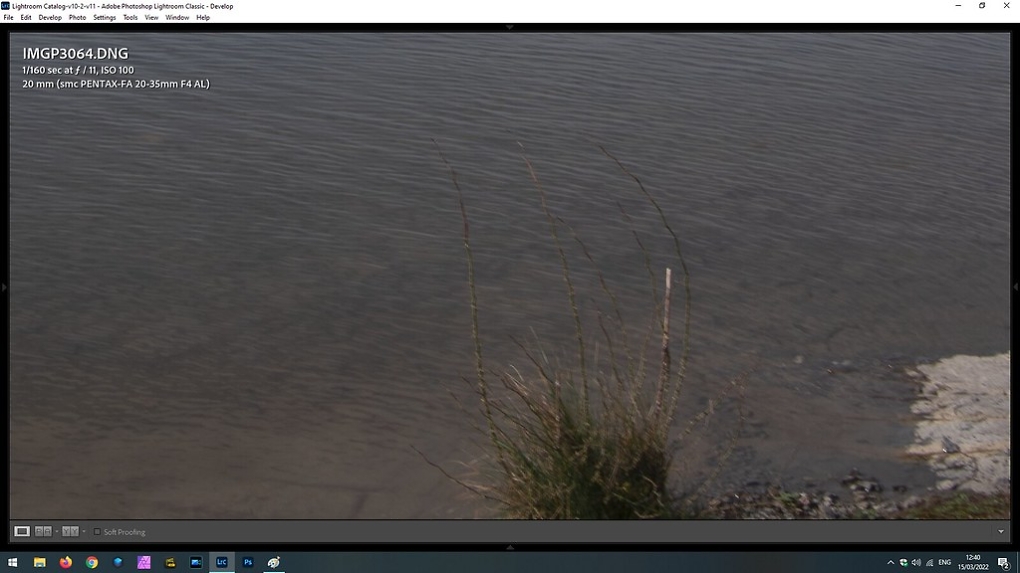

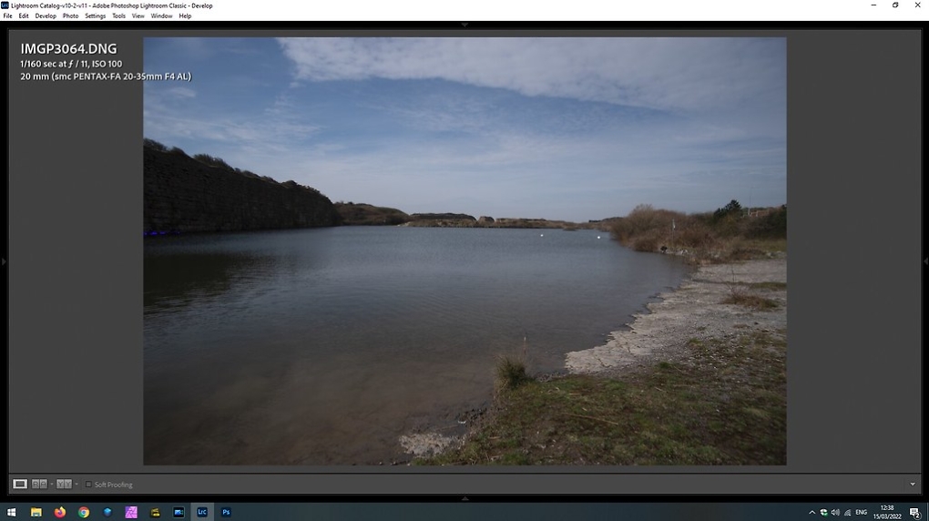

Here's another example of what I mean.
All these images were shot today on a dog walk.
Focused on the greenery sticking up, I'd like to think there was enough contrast there to lock focus good, the camera seemed to think it was focused good but when you zoom in afterwards...

Frustrating! I wonder, when they about the light hazing on the centre optics, which is there but reasonably light, is effecting the images?

Doubt it, pretty much every copy I've owned also had a similar 'funny' character about it. Also when paired with the K-1 you'll come across the horrible shutter/mirror shake too. This lens is pretty badly affected by it around 1/100s shutter speeds.Frustrating! I wonder, when they about the light hazing on the centre optics, which is there but reasonably light, is effecting the images?
Superb lens though, I don't think I'll sell mine.

What's the mirror shutter shake? Some of my images that were not sharp were around that shutter speed?
Posted 15/03/2022 - 17:46
https://www.pentaxforums.com/forums/190-pentax-k-1-k-1-ii/356071-mirror-slap-shu...
It happens when the mirror/shutter assembly causes vibration of the camera body as you're taking a shot. It's pretty common if you're using lighter lenses with the K-1. I've also seen it a lot when using the 28-105 (or 18-135 on the K-3).
To avoid it, use any method to increase the shutter speed beyond 1/200 or so.

Worrying as I use my K1 for work although for that I'm generally using my DFA 24-70mm on it or my Sigma 70-200mm.
So large bigger mass lenses are not affected but smaller lighter lenses are? Weird as I've never had an issue with my FA 35mm or 50mm?
Ill be doing some checking tomorrow as I have a few weddings coming up soon and I can't be having ghosting images!
