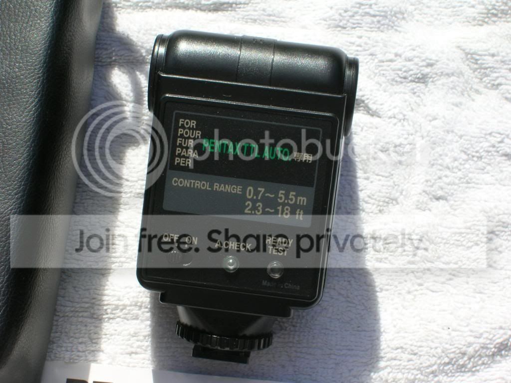

fyi the AF220T looks like this http://i983.photobucket.com/albums/ae315/odestiny/Picture1253-1.jpg
there is a A button on it...? it seems this would adjust the power no?

The A button is most likely an indicator light rather than a button - it probably lights up when the exposure is correct if it's anything like other flashes.
The AF160 is quite low powered. I only tried it on my K-m after buying it for my ME Super (which has no built-in flash at all, so a pocket-sized flashgun to go with the pocket camera is great). I will be taking it on holiday with me for that reason, the fact that it will also fit and work with the K-m is a bonus.
There is an AF240Z here for £12.50, I'd buy that in preference to an AF160.
