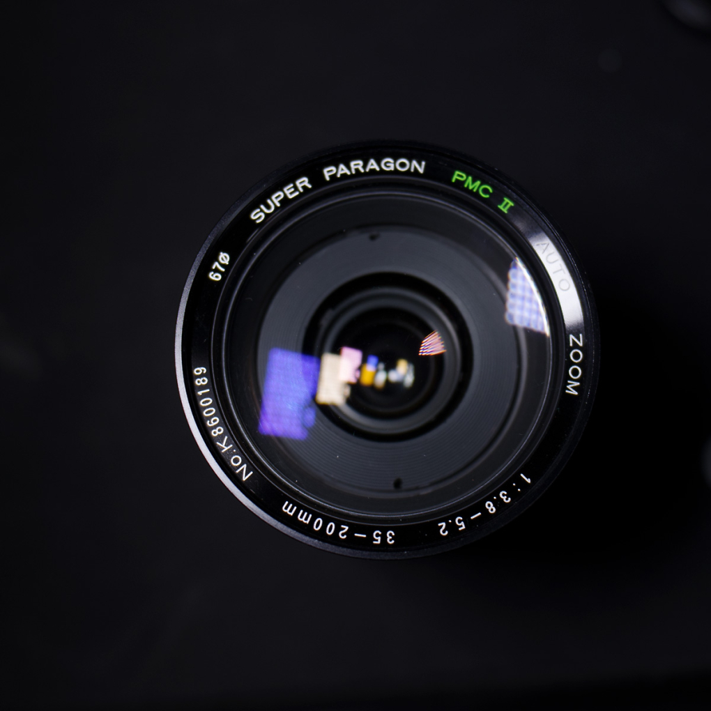

Hey folks, I have been gifted a lens and trying to work out what mount it is. I believe it as Pentax K mount (original) as denoted by the K on the serial. But the push pins on the lens mount are throwing me.
Does anyone know if this lens can be converted to work on the Pentax K1.
I can't find much information about this one online. The Lens itself in the flesh doesn't look a day old. A++ condition.
Any guidance appreciated.

The only mount I know of that has buttons like this on the lens is the Olympus OM, but they're not usually round. These ones could be round because it's a third party item.
This site seems pretty extensive and the only other possibility I see there is the Voigtlander Vitessa T and I'd think that's too old for a 35-200mm zoom.
To be honest though, a third party legacy super-zoom is likely to be of such poor optical quality that it's not worth the bother of trying too hard...

I appreciate you point about it likely not worth the bother, but there is something about obscure lenses that i like, especially when one is in such good condition. I'm now wondering if the mount has been converted previously, hence the confusion. Would still like to see how it performs if I could.

It certainly looks like OM, while the buttons are not usually round I have at least one third party lens that does have round buttons.
To confirm the greater diameter of the OM mount (across bayonet tabs) is ~46.7mm and without the tabs the diameter is ~44.2mm.
OM has a horizontal locking pin near the end of one of the bayonet tabs.
Perhaps useful is the note I have that the lens can be used on PK bodies upside down if it is held against the cameras mounting flange.

I had noticed upside down the lens felt like it should fit but sadly not. I reached out to the website owner for the link Johnathan posted and he confirmed that the mount was for OM so, I think its safe to say this might be going on ebay! - Thank you all for your help.
