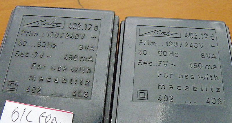

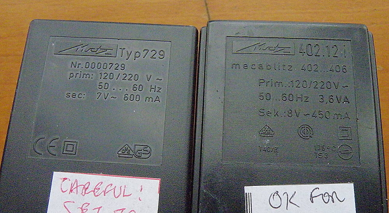

Mecablitz 45 series Battery Chargers -- I have 2 chargers with British 3 pins and 2 from a Camera Club member who gave me 45 CL-1 units with GERMAN 2 pins Also the British units 402.12 d are 7 V 450mA and one German one is marked [b402.12 i and 8 V 450mA and the other marked 'Typ 729' is &v 600mA !!! ][/b] I have a 45 CL-4 which came with NO Battery charger from the Widow Lady and evidently THAT requires a type 703 battery charger -- a PLETHORA of Different Chargers ! -- which do I use with the 45CL-3 I have and the 45CT-1 and 45CL-1 ? The Donor of 45 CL-1 units said he had used the 220V set ones OK in UK on 240 V !

Using 220V AC-rated kit in the UK on our 240-250 AC V supply should be no problem - either rating or safety-wise (kit for both voltages has exactly the same safety test requirements!)
However the output voltage must match what the target unit (i.e. the flash unit) is specified for, and the output current capability must be at least equal to what the target unit requires (doesn't matter if its a bit higher - say 20-30% or so - but should not be a lot higher, like 200%)
