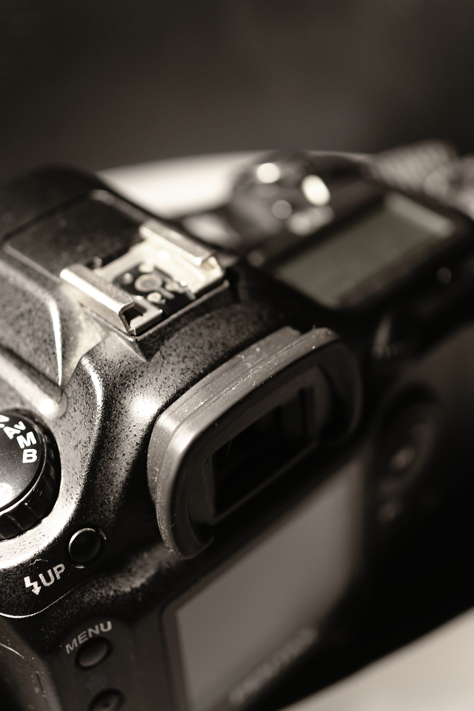

Hello clever people,
A follow-up question on the Pentasx istD s.
On the Pentax K10D there's a 'slider' making it possible to align focus with my moderate nearsightedness, if I remember correctly it's the same on the K5. On the K1 it's even more precise with the small wheel.
But there does not seem to be any adjustment options on the istD s. Can someone confirm this? Perhaps the function is hidden somewhere else?
And, in addition, is there any adjusments possible on the ist D (non-S)?
The focus I get now is not correct / suffient, and the autofocus beep confirmation does not seem very precise.
Thanks in advance!
-- Kasper Bergholt
Edited by kasperbergholt: 14/11/2024 - 18:50
PRYorkshire
Posted 14/11/2024 - 19:55 Link
The istD has a slider above the eyepiece
Paul
johnriley
Posted 14/11/2024 - 22:13 - Helpful Comment Link
As does the *istDS. This is the dioptre correction adjustment and it is to make sure your eye is focusing on the focusing screen without straining. The optical distance of the screen is about 1 metre, so some may find it hard to see a sharp image. Point the camera at a light, blank surface and change the setting till the etched lines in the viewfinder are sharpest. Then forget about it.
This will set the viewfinder up for your eyesight and manual focusing in particuylar will then be much easier.
Posted 15/11/2024 - 00:49 - Helpful Comment Link
While the slider is in full view on the DS it is necessary to slide the eyecup up and off the istD in order to access it. Don't forget that there are extra eyepieces available (sometimes - e.g. on ebay) to correct the view even more -- I have one on my K5.
My page on Photocrowd
kasperbergholt
Posted 15/11/2024 - 17:29 Link
Thanks all, excellent advice!
The slider is indeed there below the rubber. But it's well hidden.
