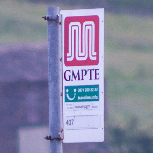

This morning, I spent a little while taking test shots at each aperture setting over the garden fence towards a bus stop that is at least 100m distant. The shots were taken as RAWs using a K30 and processed pretty much as I normally would in Lightroom 5.3. I then exported full size JPEGs from Lightroom and used Elements to take some 500 pixel square crops.
This was the full frame, taken wide open
Crops at:
f/4.5
f/5.6
f/8
f/11
f/16
f/22
On balance, I think the Tair's reputation is probably justified. It seems to be pretty sharp at all apertures and, as might be expected, is best around f/8 or f/11. Although I haven't yet done the bus stop test with my Pentax 55-300mm zoom, I *think* that the Tair wide open just might be as sharp or sharper than the 55-300mm at 300mm, at any aperture. I'm also rather pleased that the amount of fringing is small and only rarely seen and that there is just about zero CA.

Over a year on, I happened to be pointing my Pentax DA 55-300mm over the fence after setting the micro focus adjustment. The is a 100% crop using standard phase detect focussing at 300mm, f/11.
Yes, they have changed the bus stop. It's interesting to compare the result with that for the Tair lens above. Not much in it, is there?

Link Posted 12/11/2015 - 09:15
The lettering on the Tair isn't black until f/16

Link Posted 12/11/2015 - 10:12
The bus stop is over 100m away. The DA 55-300 shot is sharp enough for me to leave the Tair in retirement, I think.
