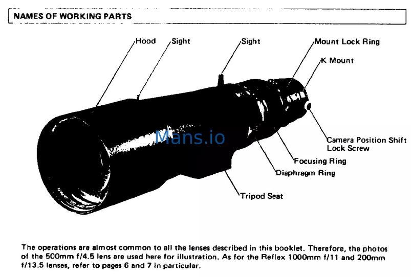

After languishing a a friend's house in Ohio for close to four years thanks to the pandemic, I now have my hands on this lens. A couple of questions if anyone has had one in the past.
The tripod mount has a large knurled knob on the right hand side. I assumed that undoing this would allow the lens to rotate in the mount, or to remove the mount? At the moment, it doesn't appear to do anything (and I'd rather not force it not knowing what it is supposed to do).
Nearer to the lens mount is a small silver knob. I assumed that this would allow me to rotate the camera on the lens to change from landscape to portrait format. Again, undoing this doesn't seem to do anything.
Any info / advice welcome.

From on line manuals Kris, the the rear small silver knob is the "camera Position Shift Lock Screw". That allows landscape/portrait views. If the lens barrel does not turn, it's dry seized. Try a single drop of WD40 and allow it to soak. The plastic "grip" cushions inside the clamp barrel may have "set"over time. It will loosen.
The large knurled knob is the mount release as the mount is interchangeable.
Don't blame you for being cautious/concerned, always a good approach.
