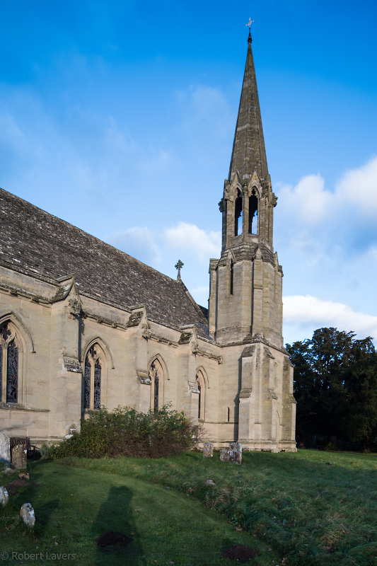

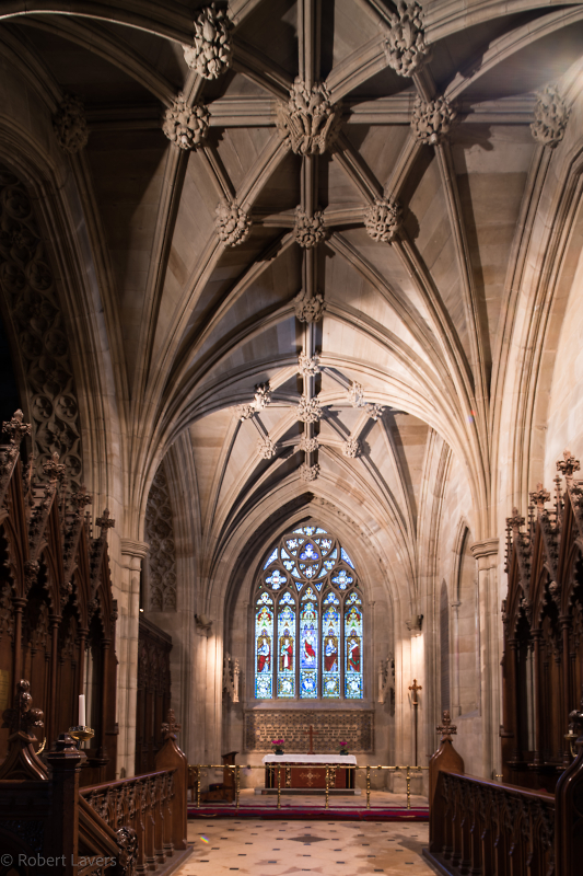

I know you are all dying to see some results so I braved the arctic weather to try a few at a nearby church. These have just had the usual tweaking in Lightroom - clarity, shadow lightening, etc but no perspective correction nor CA correction. A couple aren't as sharp as they could be but that is down to my manual focusing.

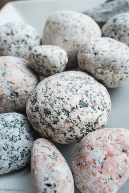

Ok, a couple more for HarisF1. This time to demonstrate the tilt function, and taken this time in good light and in the comfort of my home. I have found turning off focus peaking in live view gives much better results not just with this lens but generally, so these were both on a tripod and remote release at f11, 0.5" and iso100. Very close to the subject, and closer than the distance scale on the lens indicated so I have decided to ignore that in future. I wasn't at the closest setting so scope for close-up photography although you have to be careful not to brush the lens against the subject! So, here's the first one with the tilt in normal position:
And tilted downwards -8:
You can see how the depth of field is increased with the tilt, and also I am really pleased with how sharp these have turned out, and I cannot detect any CA either so feeling much happier.
