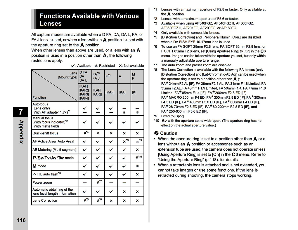

Copy of page 116 of the K3iii manual re lens usage, says it restricted but not what the restrictions are.
