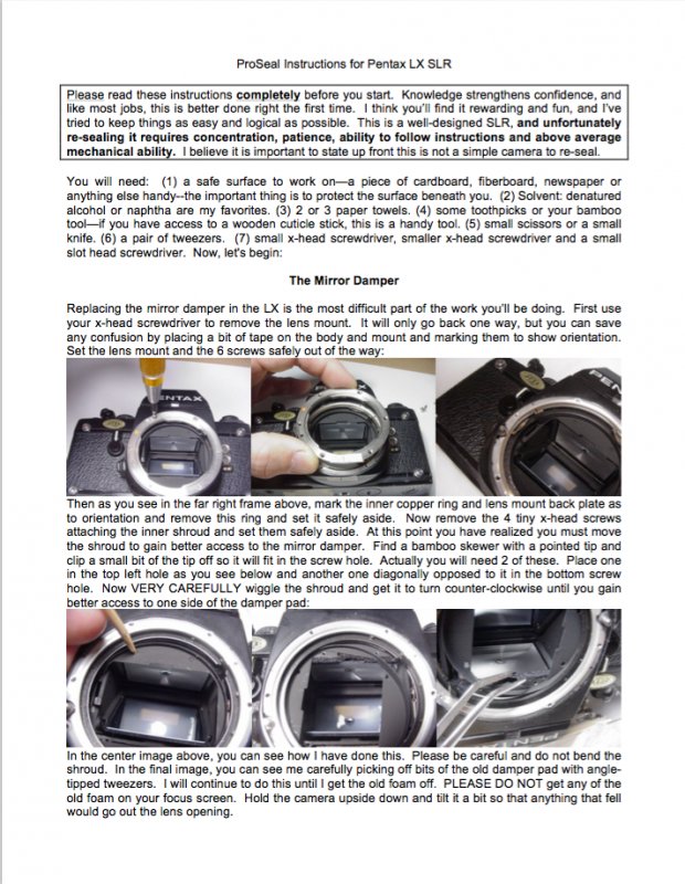

To replace them you need to remove the lens mount and the 4 screws to the shroud behind it. You then need to rotate the shroud 90degs to gain access to the remains of the old foam to clean and remove it.

Seems like over complicating the job to me, but I don't have an LX to check. Certainly EVERY other pentax slr I've done it on does not require removing the lens mount, or any other part for that matter

I've done foam on the MV & ME which was straight forward and easy to get to without any disassembly, but the foam on the LX sits behind the shroud.

I do have an LX but I don't consider myself competent enough to replace the foam on it - it isn't as straightforward as on some other models (as per the instructions in co049's post).

Jonathan it's not a simple task, I have done MV, ME & MX dampers but on the LX its hidden behind a shroud that needs to be removed first.
