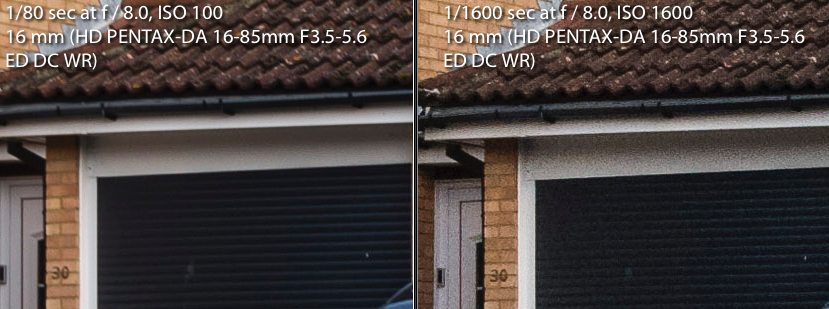

I have just been outside to get a street shot. Taken on a tripod and I just kept upping the ISO. The difference between ISO100 and ISO1600 is huge. Check out the white plastic area of the garage. This is grabbed from my screen and the saved as a JPEG at the highest setting.

Any comments on the garage screenshot above? I cannot believe this level of noise, but I somehow cannot believe either that my K3iii is somehow noisier than others. It was made in Sept 2023 so is very new. Hopefully it's not a lemon.
In the garage shot, both shots were perfectly exposed. Just in case someone think the one shot was massively underexposed and then pushed in processing.
