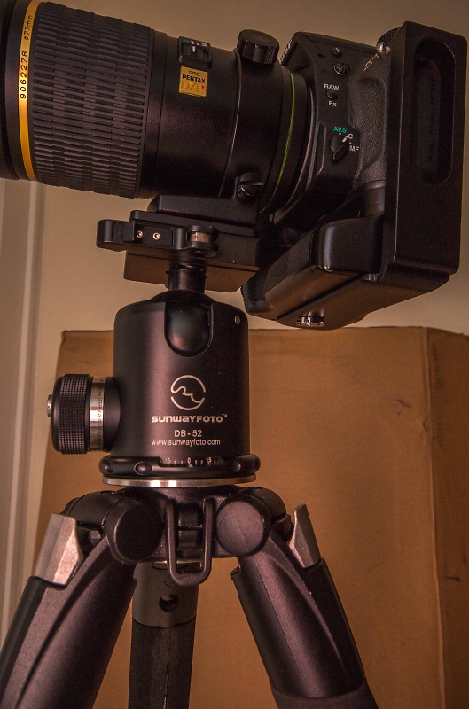

Link Posted 06/12/2015 - 19:32
Algernon wrote:
It's a pity the lens hasn't got Sigma's OS (Optical Stabilizer) function. It's almost impossible to hold a 500mm or longer lens steady on a tripod. I tried a 2x TC on DA*300mm and the only way I could steady it was with another tripod supporting the front of the lens with one of these...... Forked_support_ebay
The Pentax SR switches itself off when you select remote + delay.
Hope I'm not going to far of topic but thought it might be helpful..
I can highly recommend this ballhead for anyone using long lenses ..it's absolute rock solid when locked. I use the DA300 + DA (SR switched off) on this without any issues (even in Scottish weather) When using this the weak part will be the tripod.
