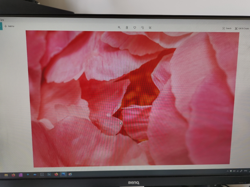

Your problem is Windows built in picture viewer which is now just called "photos". It is not a colour managed application. It does nothing with the sRGB profile tagged to your image. If you use a wide gamut monitor the oversaturation will appear even worse. Use something like "FastPictureViewer" freeware and set up colour management within it to get the same image as you see in LR.Viewing them using the built in picture viewer in Windows 10 but on the same screen / computer as Lightroom they were processed on.

Posted 17/05/2020 - 12:06
That pic viewer is amazing and now set to default image viewer on the desktop.
With built in Windows photo viewer
With the freeware FastPictureViewer
As a test I also drag and dropped a pic into Firefox address bar and this also was correctly coloured.
Now, is there a way that the thumbnails in the folder are also done through FastPictureViewer so these look correct also?

I know Lightroom uses ProPhoto RGB colour space and exports in sRGB as a default and this hasn't been an issue before as I have a calibrated monitor and what I see is what I get back but today I exported some images and they were extremely over saturated and not like I was viewing in Lightroom on the develop module.
I've tried on export changing the colour space to sRGB, ProPhoto RGB and Adobe RGB 1998 and nothing is making a difference?
I'm wanted to output what I'm seeing when I'm processing images but it's way off.
