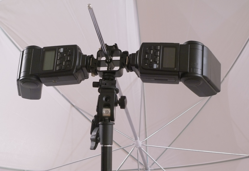

The shots were lit with 2 Cactus RF60/x flashes on a a multi adaptor firing into a white reflective umbrella ....
The backlight is kindly provided for free by the sun, and the ambient exposure was dialed down a couple of stops to reduce clutter behind and keep the rim light under control .....
The trigger is the Cactus V6II, set to TTL mode. Both flashes work on the same group and fire together. The light ouput automatically divides evenly between the two..... having two creates a wider spread of light and also allows faster recycling due to halving the power used by each flash to achieve the exposure.
