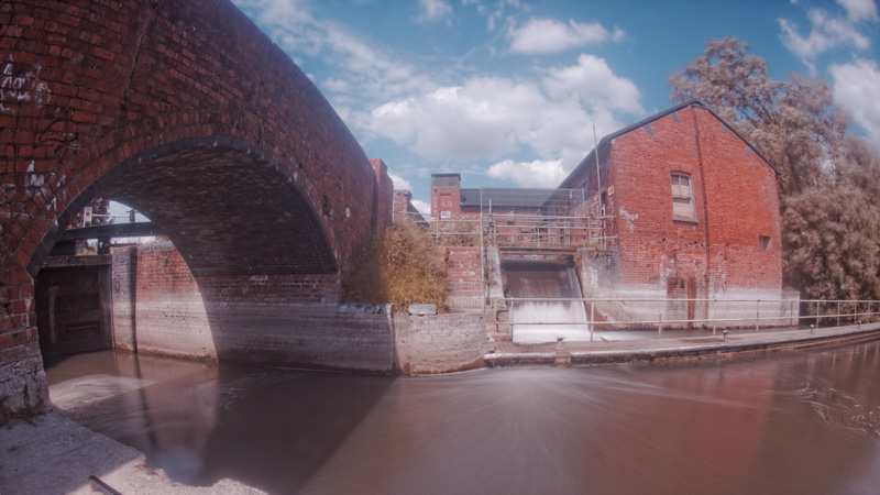

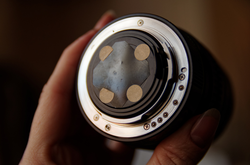

I gave it a try the other day and it seems to work, fixed the gels to the back of the lens using dot stickers as it made it quick to do when out and about.
I tried stacking a number of 3 gels, this photo also had a half gel for the top half of the photo (its worth remembering that the image comes out of the lend upside down) As you can see there is a strong color cast. I could not retrieve the greens.
here is a black and white conversion.

well done for trying but are these genuine gelatin filters or bits of plastic that are used in front of lamps? In the photograph of the lens that doesnt look like a real gel to me.

What i used was this Rosco Strobist. It is a bit of plastic that you put in front of flash, but often referred to as gels.
Do you have something that would be more suitable in mind that you could point towards.
gartmore
Link Posted 23/06/2014 - 16:20
I thought it was something like that. Proper gels are actually made from gelatin, hence my earlier remark about not getting them wet - they will dissolve. Many camera filters are actually a sheet of gelatin sandwiched between two pieces of glass. This is what you are looking for link
