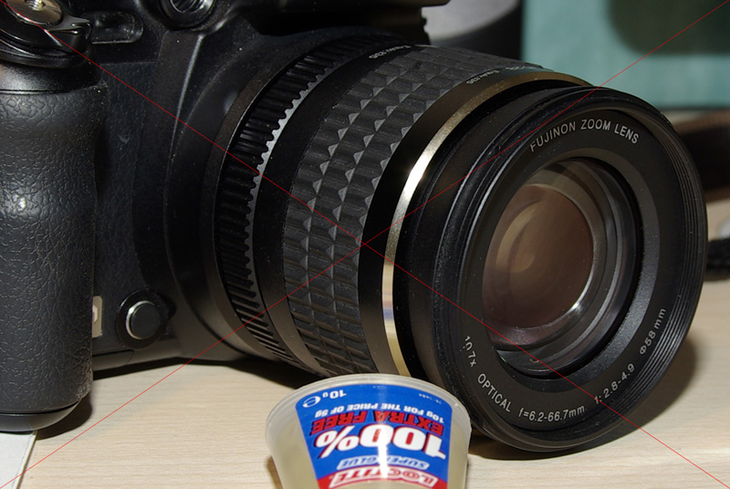

I was worried that if I missed the thick focus line (which the red lines indicate I did) then the camera would try and find something else.

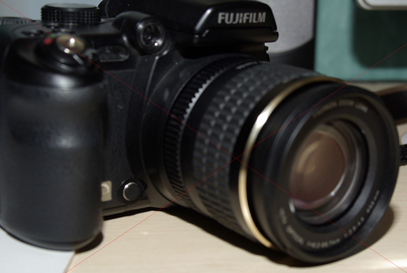

before and after... actually this first one looks just plain out of focus, bad example possibly, but you'll have to believe me when I say that the images just got better and better until I stopped and did the test chart. (I was focussing on the silver ring, the red line indicates the geometric centre)
