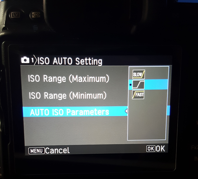

I thought this behavior was goverened by the ISO AUTO SETTING > AUTO ISO Paramerters (SLOW - Normal - Fast) on page one one the camera menu:

I thought this behavior was goverened by the ISO AUTO SETTING > AUTO ISO Paramerters (SLOW - Normal - Fast) on page one on the camera menu:
That is likely true Brian but the manual does nothing to actually explain properly what that setting does, not to me anyway.
Yes, was going to say just this.I thought this behavior was goverened by the ISO AUTO SETTING > AUTO ISO Paramerters (SLOW - Normal - Fast) on page one one the camera menu:
Control over the exposure calculation is provided by this setting on the higher end cameras, and I absolutely love it.
Traditionally the speed settings always favoured lower ISO values, and often made up for this with longer shutter times, which introduced blur or movement in my shots (even on quite bright sunny days). I found the above setting when travelling in Vietnam, and it was a welcome revelation that I could influence this behaviour.
Setting this to fast meant I could take portraits etc without fear of blur and it was quite liberating not having to worry about this and finally having faith in what the camera would be selecting. Well worth looking into this setting, if you haven't really noticed it before.

IIRC It's been in top of the range menu since the ist*D, it used to be called "Program Line".

Just to point out that the 'Program Line' settings relates to the Program mode (presumably that mode only.) Peter's description of the AV + Auto ISO relates to aperture priority (Av) mode. That's actually really useful thanks.

The program line option goes back to the SFX (and arguably the P50). In program 'normal' the SFX would alter the program line depending on lens focal length (and show it on the LCD) but it wouldn't be able to match 1/focal length.
