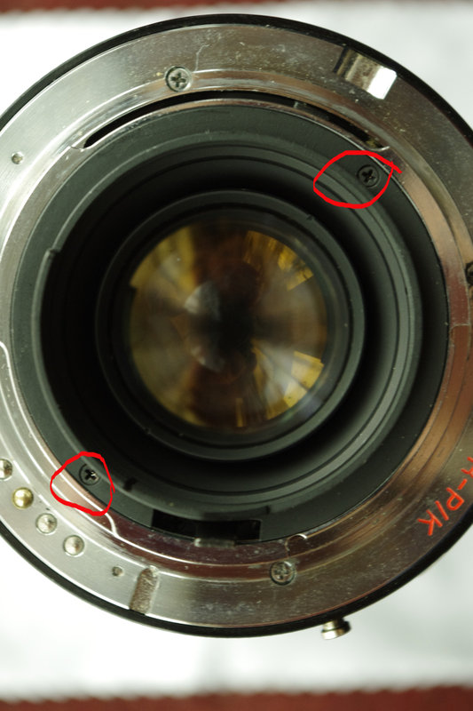

Hi!
I bought it few day ago (eBay) and i would like to use it with my Pentax K-r camera. Which one adapter ring needs for it? Thanks for help!

You've lost me a little. If the lens is PK-A, no adapter is required.
Can't help wondering if the lens was described incorrectly on ebay.

VIVITAR 28-200mm f3.5/5.3 MC MACRO FOCUSSING ZOOM LENS Pentax PK/PK-A Fitting.
That's why I don't understand it. I tried it, but it doesn't work.

Link Posted 01/09/2012 - 11:18
You will have to reduce the length of the light guard beside the aperture lever.
Cut it down to match the Pentax one. Also remove the Richo pin if it has one (my one did)
You will have to remove the ring for cutting to avoid grinding particles getting into the lens, it is not difficult to do.

Link Posted 01/09/2012 - 11:21
The lens has an extended flange at the back. You can see it in the third picture. I had a Vivitar with the same problem. While it mounts ok on an older film camera (pre-AF) it will damage the inside of the mount on a DSLR because the extended flange hits what are now the SDM contacts (formerly power-zoom contacts). Below is a picture of my lens with the extended portion removed.
You need to remove the black inner part of the metal mount to avoid damaging the optics, and cut the excess flange off with a hacksaw or similar. Alternatively, you can remove this part and leave it off, but it leaves the optics open to dust and the aperture lever unprotected from damage from impacts.

voneout
Link Posted 01/09/2012 - 12:51
Good luck
If I remove those two screws, can I change it? Can I buy the right one for me? I would not want to cut it.
How do you call this part? Thanks!

PeterKR
Link Posted 01/09/2012 - 21:43
I had a similar problem with an old P/KA mount lens which also had the extended flange.
If you are careful you do NOT need to dismatle the lens to fix it !
I made a circular seal from thick card to stop filings getting into the optics.
Just cut a small circle (which you estimate to be a little bigger than the rear element) from paper then try it for size.
Once you have the right size cut a very slightly bigger circle from thick card and 'roll' the edges to soften them. You will then find you can push the seal over the rear element to make an effectice dust seal.
I then cut the flange to match a Pentax DAL lens. I used a thin needle file like a small saw, first downwards then along the side to weaken it and it then snapped off easily. Then simply smooth off the edges with the needle file.
Carefully remove ALL of the swarf and THEN remove the card seal (pick it out with a small spike, pin or needle)- job done !

voneout
Link Posted 02/09/2012 - 11:10
Good luck
Could you put the picture to here about your job?

Algernon
Link Posted 02/09/2012 - 11:33
You can mask off the rear of the lens with just masking tape.
Anywhere there are gaps that you can't get masking tape just
seal with pieces of thick string/twine pushed in and carefully
removed afterwards.
You will need a Dremel to cut the metal off.
Algi
PeterKR
Link Posted 02/09/2012 - 12:14
removed afterwards.
This will work but you might get adhesive from the masking tape stuck to the rear element.
If you can cut a card ring as I suggested there is no problem.
Also, if you don't have a Dremel there's no need to pay out for one. A cheap set of needle files from Screwfix or Toolstation will do the job.
Firstly mark the flange area to be removed with a soft pencil or scriber (sharp point)
Select a file that is a very narrow triangular shape and it can be used to saw down, making a narrow 'V' slot.
Then use it sideways to cut a groove around the flange and you'll find the unwanted bit snaps off easily.
Then just 'RASE',(Remove All Sharp Edges) as they used to say on engineering drawings.
Good luck
Algernon
Link Posted 02/09/2012 - 12:18
Sorry I should have mentioned the rear element needs covering
with a non sticky material such as a card disc.
Algi
Jonathan-Mac
Link Posted 02/09/2012 - 15:21
Debris is not the only risk to the rear element. If the saw slips, it could cause damage despite any card or plastic placed over it.

Link Posted 13/09/2012 - 21:04
It's done!
Cost:
A Dremel clone from Aldi: 8pounds
HILKA 15pc PRECISION SCREWDRIVER SET from eBay: 9.97pounds
Thanks for helps!

Link Posted 13/09/2012 - 21:28
Hi, again.
Glad you managed to trim the unwanted material away.
However - BEWARE !
I just noticed 2 things !
1) The lens is marked P/KA R P/K.
This would suggest that the 'R' indicates a RICOH fit !
2) This means the flange has a special extra for the Ricoh cameras. Whilst this is normally a small PIN which may or may not lock solid onto a K-r (BIG problem) I noticed what appears to be a small leaf spring (see near the top of your photo just above the red circle)
This might also lock onto the K-r so should be removed !
Look at one of your genuine Pentax lenses and you will see what I mean.
I hope you have NOT already tried the lens and found a problem ?
