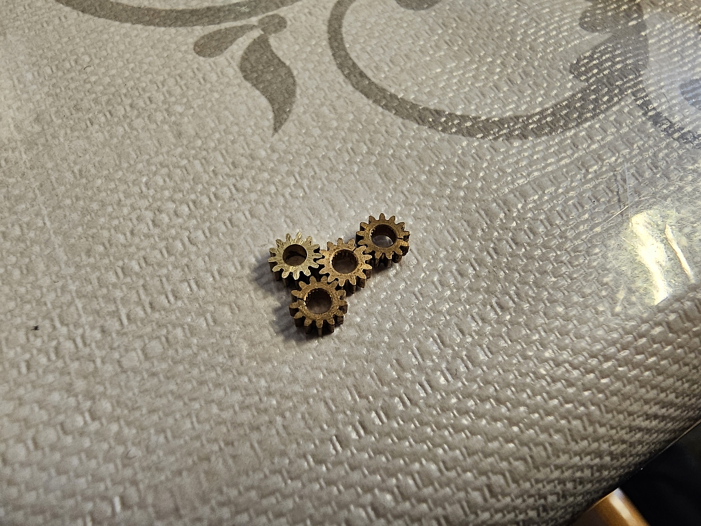

Posted 11/06/2024 - 22:21
LennyBloke wrote:
Bit of an odd one here - I have a Pentax FA* 85mm f1.4 in overall lovely condition but its AF is starting to fail, sometimes it works fine others it sort of "slips" a bit, so I would imagine it will fail completely at some point!
Not sure how to price it, because other than the AF it is excellent. I believe the parts for AF repairs are very difficult to find nowadays, so it's better to accept that this is a Manual Focus FA* portrait lens.
My FA 77mm Ltd started going the same way at the weekend, firstly a bit of slipping and then when using manual focus ring would only move a few degress but AF worked fine, and then it stopped completely. Now, as this lens was bought in Japan on a business trip in 2008, I am not going to give up on it and already made enquiries at the Brentford guys. If they can repair this one, I might trust my FA*85 with them as that isn't working 100%. It's the prime lenses that keep me interested in the Pentax system and save money by not going full Nikon Z8.

Posted 12/06/2024 - 12:16
The FA77 has a different gear size to the 85. If I can somehow get the right dimensions I can have the gear ordered.
So far this is what I have:
FA*85 - 0.3 Modulus, 13 Teeth, 2mm Hole, 2mm Height
FA 77 - 12 Teeth, 2mm Hole, 2mm Height - not sure if 0.25 or 0.3 Modulus.

Posted 04/09/2024 - 11:59
My 77mm is back from John Pye... working well.
