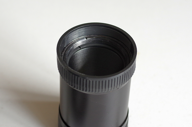

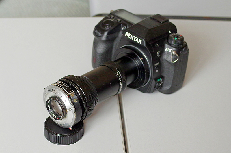

I'll take some photos of it.
It is two tubes about 3.5inches long, one inside the other, with a T2 fitting on the camera end and a female thread of about 34mm at the other, which is useless. I tried some step ups but it's between 34 and 35mm and none would fit so I couldn't get a lens onto it. I bought a solid looking M42 lens cap off Ebay, screwed it onto a 10mm extension tube and fixed this onto my lathe. I then cut into the flat end of the lens cap to leave an M42 threaded tube and then cut into the inside wall of that tube (the ex lens cap) a fraction at a time until the end of the trombone tube thing would just fit inside it. I secured it with Araldite and left it overnight. Now I have a robust M42 fitting on the end of my tubes. The outer tube has a locking ring so when you've used it - like a trombone slide - to focus, a quick twist secures it. The addition of a focusing helicoid between the tube and the lens could even tweek things further (I leave the lens itself set at infinity).
Posted 05/08/2020 - 12:47
Some photos of the tubes in question ....
The Schneider lens is shown simply because it has a helicoid attached. Part of the strange rendering doubtless comes from the
restricted diameter of the tube - compare it with what is potentially available at the camera end. When processing the images
it is necessary to make a huge adjustment to increase the brightness.
