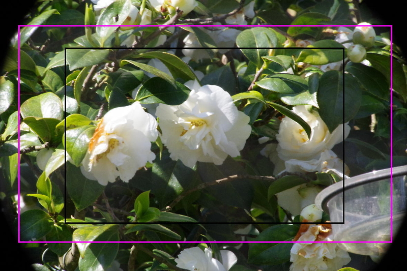

The image here (300mm+1.4x) for instance would be cropped roughly as shown in magenta, with the black box showing approximate camera crop size:

The 300mm + 1.4x converter was losing a bit more corner than I'd hoped, but it's still able to provide far more than using camera crop mode.

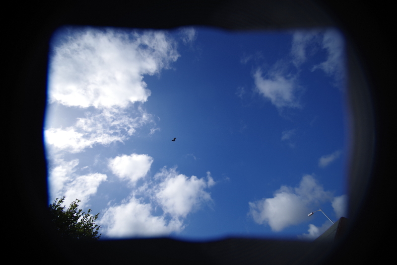

* I also noticed the Sigma hood is remarkably close to the crop size, a bit over 100 pixel border and near rectangular - this is why I didn't use hoods for the test:

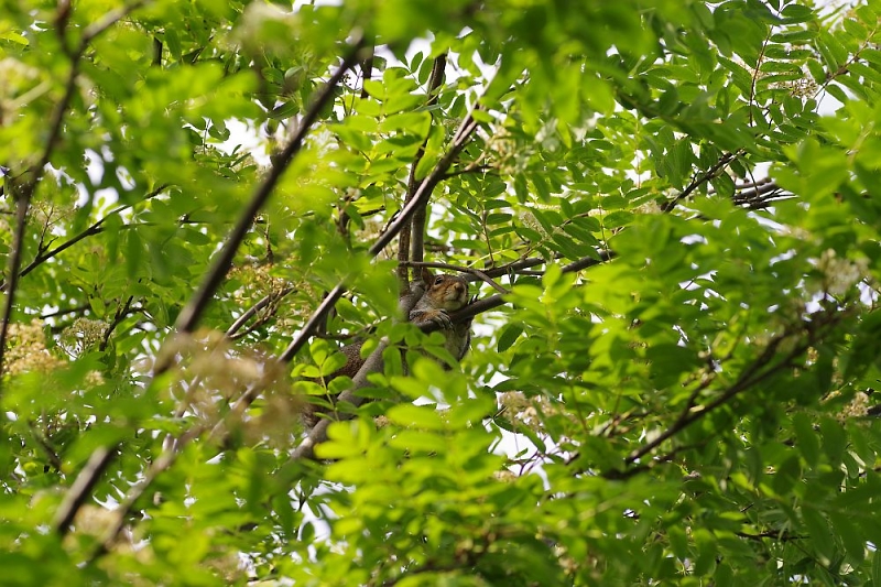

Posted 14/04/2020 - 13:32 Link
Example of a severe crop with the K1. The crop does look oversharpened but shows what you can do.
Edited by pschlute: 14/04/2020 - 13:34

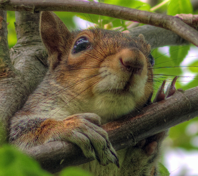

JAK
Posted 14/04/2020 - 14:13 Link
Or this:
